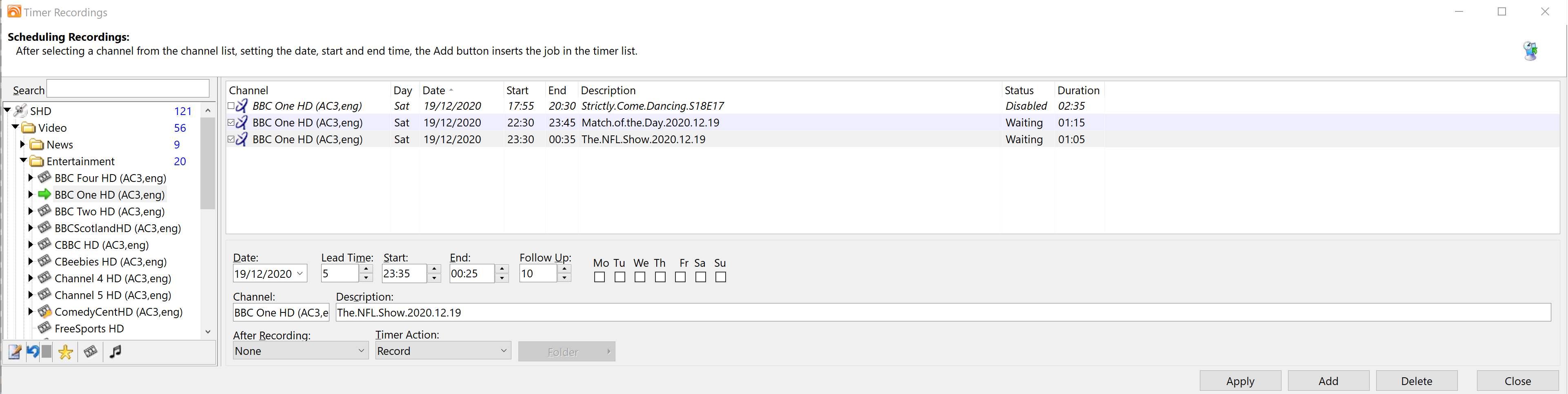

Hello, I had a recording set for "Strictly Come Dancing" on 2020.12.19 on 28.2e.
When I went to check the recording it only recorded the first couple of mins of the show
I then checked the "Timer Recordings" window and it had been set as Disabled.
The Channel is FTA, Recording location had over 2tb free, Tuner was free ect...
How did this happen and what is "Disabled"?
