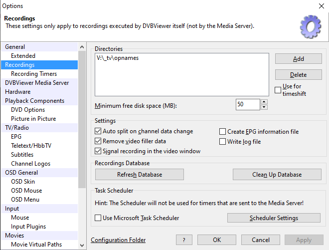

Options -> Recordings -> Create EPG information file.

Hi Griga, thanks for replying so quickly.
I had already switched off Options -> Recordings -> Create EPG information file, but the behaviour I described still happens. What can I do to stop it?

Most likely one of the DVBViewer databases (either the recording database or the media database) is already corrupted, so DVBViewer can't write to it anymore when a recording starts or is finished. In this case DVBViewer creates an EPG Info file as last resort for preserving the metadata for the file.
The database files are located in the Database subdirectory of the configuration folder. Close DVBViewer, move the file MediaDatabase.db3 to some other location and try if this fixes the issue. If not, do the same with the file TVDatabase.db3.
Missing database files are automatically recreated by DVBViewer when it is started. However, they are initially empty, thus requiring a database update to fill them again. In case of the recording database it only works for recordings with a txt file.
