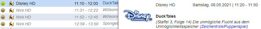

x112 Posted May 7, 2021 Author Share Posted May 7, 2021 I think it has something to do with the "clear EPG" option in XEPG. I also get timers based on the DVB EPG and not on the external EPG. If i delete this timer and call the auto timer task then i get this timer (disabled is correct). Quote Link to comment
