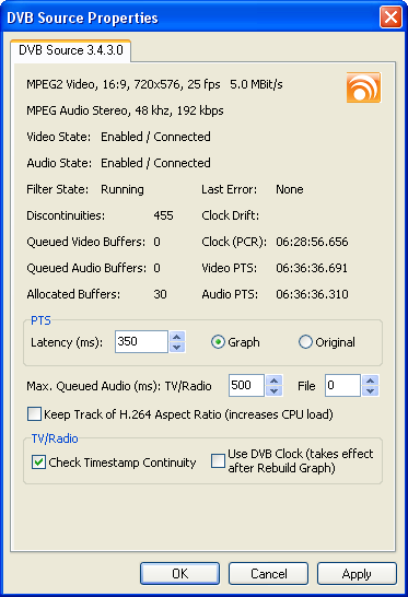

Sean99 Posted June 22, 2021 Author Posted June 22, 2021 21 minutes ago, Griga said: Forget it. That can't fix it. Most likely DVBViewer already receives corrupted input, which means, it's a reception/hardware/driver problem, not a playback issue. Even cannot change a little bit! Please tell your choice. 21 minutes ago, Griga said: Even old DVBViewer versions used the DVBViewer Filter. In versions before 5.3.0 the filters sub-menu was located in the view menu. Oh yes I found it, thanks a lot, I ran DVB Sources and took a picture and attached it. Should I do anything else? 21 minutes ago, Griga said: Digital Devices cards are known for good quality. However, they are quite expensive. Quote
Griga Posted June 22, 2021 Posted June 22, 2021 455 discontinuities, which means 455 drop-outs in the arriving data stream. That confirms my assumption. Quote
