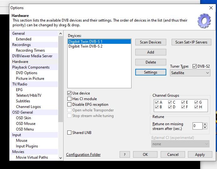

Two tuners are detected in Hardware Devices, the settings are exactly the same:

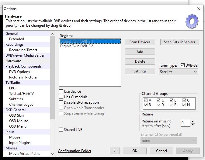

Please reproduce the problem in DVBViewer Debug Mode, as recommended here (by setting the first tuner to "Use device off") so that server error messages appear in the DVBViewer.log, and attach another support.zip.
So I switched off the first tuner, clicked on Apply and plugged the sat cable into tuner n. 2:

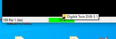

If I hover with the mouse pointer on the signal bar, it shows that tuner 1 is involved, but this channel is on Hotbird, connected to tuner 2.
