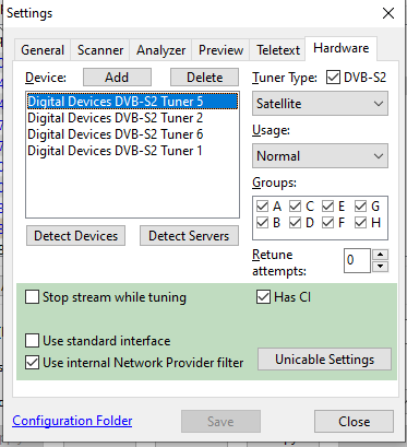

Best way to find out would be creating a support.zip in debug mode, like described here: support.zip . And perhaps a screenshot of TransEdit tool, analyzing the transponder of the channel while no audio found in DVBViewer. As I see you have multiple tuners so it should be possible to check with TransEdit while watching.
Thank You HaraldL
I will try with Support.zip first. Have never used TransEdit, so my skill with this tool is zero
The support.zip originates from the client PC, not from the server PC where things are actually happening... ;)
Since the channel in question is encrypted, a possible reason for missing audio is failed decryption. The recorder discards elements that are still encrypted.
TransEdit should be used on the server PC:
  • Store TransEdit in the DVBViewer program directory of the server PC (where DVBViewer.exe is) and launch it.
  • Go to Settings -> Hardware and tick "Has CI" for your DD Cards that are associated with a CI. Click Save.
  • Select the transponder list for the satellite position that you receive on the left side of the TransEdit main window.
  • Select the frequency of the channel in question on the right side.
  • Click Analyze.
  • The Analyzer Window enumerates all streams including their PIDs that are broadcasted on this frequency. Check if the audio stream in question is among them.
  • Right-click the audio stream in question and click "Descramble". If it gets decrypted, it should turn from red to black.

What about video? Can you decrypt other channels in this way?
Make sure that the Analyzer uses a device with assigned CI/CAM and "Has CI" checked. TransEdit allocates the first free (!) tuner from the top in the Settings -> Hardware -> Device List. If it is occupied (e.g. by the Media Server), TransEdit will use the second suitable device, etc. So it is recommendable to stop the Media Server while you are testing with TransEdit.
All 4 tuners have Has CI checked
When i Descramble video, it turns black:
Made a complete shutdown of server. Looks like it solved the problem, but i am not sure, because before it sometime worked and sometime not. I will come back here if it fails again. When i Descramble Audio in TransEdit now,  text turn black
