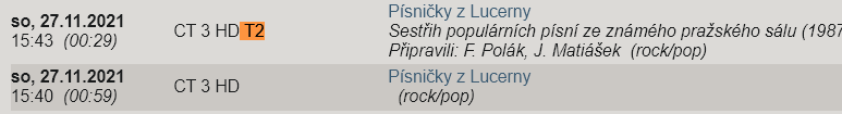

jirim100 Posted December 1, 2021 Share Posted December 1, 2021 When I delete recording in the Web page -> Recordings and then I reload Web page -> Recordings the recording is still in the database. Here is onscreen recorded video how I deleted this recording plus .db3 database file: https://www.transfernow.net/dl/202112019Ii1J4oO/uEfiCdlK Quote Link to comment

jirim100 Posted December 2, 2021 Author Share Posted December 2, 2021 (edited) Most recordings don't have .ts file on the disk and they can be deleted without any problem (as you can try/see with this .db3 database). I didn't with the database of recordings nothing illegal. After recording of .ts file is finished on some of them (and on this affected recording too) I do the following: - 1. Wait until .ts file is not locked by another process (but max. to 2 minutes - after file is still locked I do nothing) Spoiler // This function is called every 100 miliseconds. public static bool IsFileReady(String sFilename) { // If the file can be opened for exclusive access it means that the file // is no longer locked by another process. try { using (FileStream inputStream = File.Open(sFilename, FileMode.Open, FileAccess.Read, FileShare.None)) { if (inputStream.Length > 0) { return true; } else { return false; } } } catch (Exception e) { return false; } } - 2. Obtain recording id from database by the api: string request = "http://localhost:8089/api/sql.html?rec=1&query=SELECT idRecord FROM recordings WHERE Filename = \"" + System.Web.HttpUtility.UrlEncode(file, Encoding.UTF8) + "\""; - 3. When is obtaining of the recording id success then I delete recording (no file) in database: string request = "http://localhost:8089/api/recdelete.html?recid=" + recording_id + "&delfile=0"; - 4. Some of the recorded .ts files I then rename or even delete. But with this affected recording - no rename and deleted the next day. I don't know what DMS do after recording is finished. Maybe the sql command in point 3 "interfere" with some sql command performed by the DMS? Maybe precedes some command performed by the DMS? 1 hour ago, Griga said: I guess the index in your database file is broken somehow Or maybe is problem with generating the index for the database? About this time start two recordings with similar names: 27.11.21 16:27:00.872 W:\For The Record\Písničky z Lucerny; hudební pořad; ČSR; 1987; vysíláno 2021-11-27 T2.ts Discontinuities: 0 - Total size: 1,74 GB - Device: Digital Devices DVB-T2 Tuner 1 (9) 27.11.21 16:27:02.056 W:\For The Record\Písničky z Lucerny; hudební pořad; ČSR; 1987; vysíláno 2021-11-27.ts Discontinuities: 0 - Total size: 1,90 GB - Device: Professional DVB Digital TV DVB-T2 (15 Both recordings start about the same time: Spoiler 27.11.21 15:28:01.549 TBDADVBSky OpenDevice bvDVBSky 27.11.21 15:28:01.549 TRecording AllocateHardware Professional DVB Digital TV DVB-T2 (15) 27.11.21 15:28:01.549 TRecording StartRecording Professional DVB Digital TV DVB-T2 (15) 27.11.21 15:28:01.549 TBDADVBSky SetTuner TType: 2, Freq: 498000, Symrate: 0, LOF: 0, Tone: 0, Pol: 2, DiseqC: 0, FEC: 0, APID: 452, VPID: 451, PMT: 450, SID: 14005, TID: 1004, NID: 8395, SatMod: 0, DiseqCVal: 0, Flags: 24, Group: 0 27.11.21 15:28:02.058 TRecording StartRecording: CT 3 HD 27.11.21 15:28:02.059 SendUpdate DVBVUPDATE TMR 27.11.21 15:28:02.166 SendUpdate DVBVUPDATE REC 27.11.21 15:28:02.166 SendUpdate DVBVUPDATE RST 10274 27.11.21 15:28:02.560 TBDADigitalDevices OpenDevice bvDigitalDevices 27.11.21 15:28:02.560 TRecording AllocateHardware Digital Devices DVB-T2 Tuner 1 (9) 27.11.21 15:28:02.560 TRecording StartRecording Digital Devices DVB-T2 Tuner 1 (9) 27.11.21 15:28:02.560 TBDADigitalDevices SetTuner TType: 2, Freq: 514000, Symrate: 0, LOF: 0, Tone: 0, Pol: 2, DiseqC: 0, FEC: 0, APID: 2620, VPID: 2610, PMT: 2600, SID: 278, TID: 8465, NID: 8395, SatMod: 0, DiseqCVal: 0, Flags: 24, Group: 6 27.11.21 15:28:02.560 TRecording StartRecording: CT 3 HD T2 27.11.21 15:28:02.561 SendUpdate DVBVUPDATE TMR 27.11.21 15:28:03.845 SendUpdate DVBVUPDATE REC 27.11.21 15:28:03.845 SendUpdate DVBVUPDATE RST 10453 27.11.21 16:27:00.873 TRecording ($02841690) W:\For The Record\Písničky z Lucerny; hudební pořad; ČSR; 1987; vysíláno 2021-11-27 T2.ts Discontinuities: 0 - Total size: 1,74 GB - Device: Digital Devices DVB-T2 Tuner 1 (9) 27.11.21 16:27:00.873 SendUpdate DVBVUPDATE REC 27.11.21 16:27:00.878 TRecording Release Digital Devices DVB-T2 Tuner 1 (9) 27.11.21 16:27:00.878 TRecording Free Digital Devices DVB-T2 Tuner 1 (9) 27.11.21 16:27:00.883 TRecording Freed Digital Devices DVB-T2 Tuner 1 (9) 27.11.21 16:27:00.883 TRecording hamDeleted Digital Devices DVB-T2 Tuner 1 (9) 27.11.21 16:27:00.883 SendUpdate DVBVUPDATE TMR 27.11.21 16:27:00.887 SendUpdate DVBVUPDATE RST -10453 27.11.21 16:27:02.056 TRecording ($0283F110) W:\For The Record\Písničky z Lucerny; hudební pořad; ČSR; 1987; vysíláno 2021-11-27.ts Discontinuities: 0 - Total size: 1,90 GB - Device: Professional DVB Digital TV DVB-T2 (15) 27.11.21 16:27:02.057 SendUpdate DVBVUPDATE REC 27.11.21 16:27:02.058 TRecording Release Professional DVB Digital TV DVB-T2 (15) 27.11.21 16:27:02.058 TRecording Free Professional DVB Digital TV DVB-T2 (15) 27.11.21 16:27:02.118 TRecording Freed Professional DVB Digital TV DVB-T2 (15) 27.11.21 16:27:02.118 TRecording hamDeleted Professional DVB Digital TV DVB-T2 (15) 27.11.21 16:27:02.118 TProcessTimer Process Params 40 45 0 0 0 "W:\For The Record\Písničky z Lucerny; hudební pořad; ČSR; 1987; vysíláno 2021-11-27.ts" 2076 1176 -55 -55 27.11.21 16:27:02.118 TWinApp Execute C:\Users\troji\Documents\Visual Studio Projects\MyPDC_2017\x64\Release\MyPDC_2015.exe 27.11.21 16:27:02.118 TWinApp Working Directory C:\Users\troji\Documents\Visual Studio Projects\MyPDC_2017\x64\Release\ 27.11.21 16:27:02.141 TProcessTimer StartRecord VPS_PDC started 27.11.21 16:27:02.142 SendUpdate DVBVUPDATE TMR 27.11.21 16:27:02.145 SendUpdate DVBVUPDATE RST -10274 27.11.21 16:27:55.180 TProcessTimer NeedsEnding VPS_PDC finished 27.11.21 16:27:55.180 ReleaseStandbyblock TVCR 27.11.21 16:27:55.180 TServiceMain ReleaseReference TVCR: 0 27.11.21 16:27:55.182 SetStandbyBlock EvaluateShutdown 27.11.21 16:27:55.183 SendUpdate DVBVUPDATE PWR DESKTOP-B7NHU71 27.11.21 16:28:04.190 ReleaseStandbyblock DoShutDown But in the web interface, for one is showed duration 00:29 and on the second duration 00:59: Edited December 2, 2021 by jirim100 Quote Link to comment
