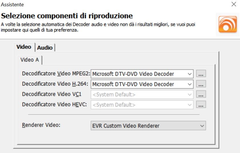

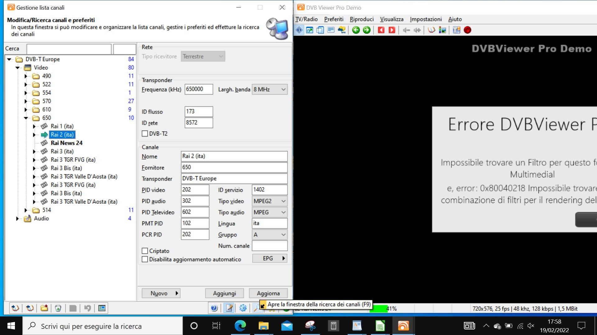

mame Posted February 18, 2022 Posted February 18, 2022 I ask forgiveness if I write in the wrong place, but I'm in IT and I don't have much command of the EN language. I am testing DVBViewerDemo before buying PRO and run into some problems, mainly with error 0x80040218. The S.O. in use is Windows 10 x64 and a search offers me many items in German, even worse for me than English, but I think the cause may be the lack of special filters for DVTB channels. I scanned the channels and tuned all the stations in the area regularly. 1- the error is signaled when trying to receive some TV stations. 2- moreover, even though I regularly see many stations, I cannot tune some of them: in this case I do not receive error reports but the screen appears black even if from "Channel list" I can see the info on the program in progress. Can you tell me what the cause may be and what I need to correct? if it is really a problem with filters can you tell me where to find them and how to install them? Thank you. Quote
Griga Posted February 19, 2022 Posted February 19, 2022 vor 8 Stunden schrieb mame: I am testing DVBViewerDemo before buying PRO and run into some problems, mainly with error 0x80040218. Most likely suitable decoders are missing in your system. Installing the LAV Filters will avoid this error. Download the installer, launch it and don't change the presets. Quote

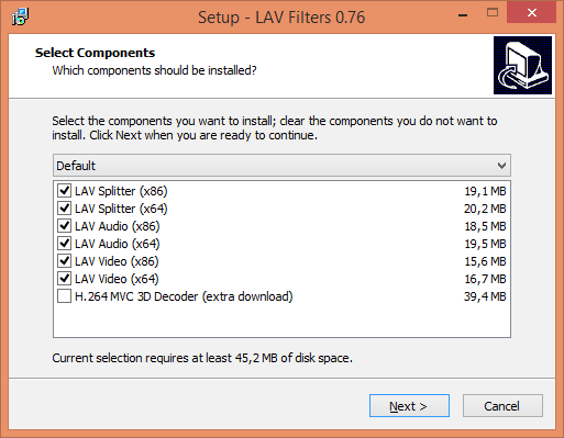

mame Posted February 19, 2022 Author Posted February 19, 2022 2 hours ago, Griga said: ... and don't change the presets. what do you mean? have I to click "Next" without selecting anything? Quote

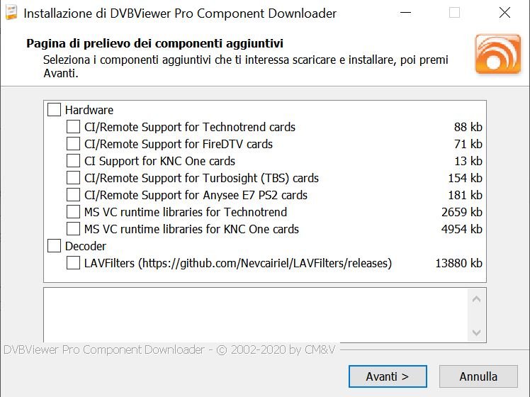

Griga Posted February 19, 2022 Posted February 19, 2022 vor 2 Minuten schrieb mame: what do you mean? have I to click "Next" without selecting anything? Don't change anything in the LAV Filters Setup after the LAV Filters installer has been launched. The screenshot above doesn't show the LAV Filters Setup, but the DVBViewer Downloader tool. You may use it to install the LAV Filters, but you can as well use the link that I have provided in my post above. Quote
mame Posted February 19, 2022 Author Posted February 19, 2022 4 hours ago, Griga said: Don't change anything in the LAV Filters Setup after the LAV Filters installer has been launched. The screenshot above doesn't show the LAV Filters Setup, but the DVBViewer Downloader tool. You may use it to install the LAV Filters, but you can as well use the link that I have provided in my post above. Really I had selected the LAV filters installation when installed DBViewer. Now I have executed "LAVFilters-0.76-Installer.exe" as suggested but nothing has changed except that by reinstalling dbviewer I get this warning of missing HEVC Video Decoder: where I can get it and install? These are the screenshots I get: Quote

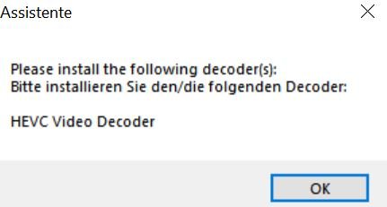

Griga Posted February 19, 2022 Posted February 19, 2022 vor 2 Stunden schrieb mame: Now I have executed "LAVFilters-0.76-Installer.exe" as suggested but nothing has changed except that by reinstalling dbviewer I get this warning of missing HEVC Video Decoder: where I can get it and install? The LAV Filters contain a HEVC decoder. The message shouldn't pop up if they are installed properly and completely. Did you deselect the 32 bit version of the LAV Filters when installing them? DVBViewer can't use the 64 bit version because it's a 32 bit application. Your screenshots don't show any sign of the 32 bit LAV Filters being present. That's why I have written vor 7 Stunden schrieb Griga: Don't change anything in the LAV Filters Setup after the LAV Filters installer has been launched. Quote

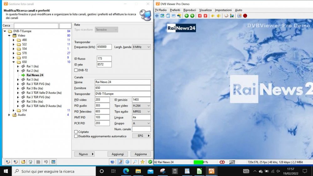

mame Posted February 19, 2022 Author Posted February 19, 2022 I have installed DVB selecting only LAVFilters when required, no other change after that. But I think HEVC is a false clue, currently in IT no channel is broadcast in dvb-t2 hevc, the problem is elsewhere. I have ascertained that all the channels received in this area, normally visible also on old production TVs, are normally receivable on the PC with another program (and the same dtv dongle decoder). With DVBViewer I correctly receive only the channels with "Video Type" H.264 (see attachment "RAI News24") while for other MPEG2 channels (see attachments "Rai2") I receive the error and the video is not visible even though I receive the audio , the EPG guide and information on the current broadcast. Quote

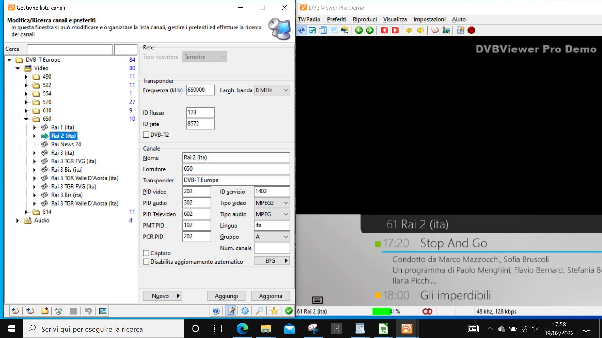

Griga Posted February 20, 2022 Posted February 20, 2022 vor 10 Stunden schrieb mame: With DVBViewer I correctly receive only the channels with "Video Type" H.264 (see attachment "RAI News24") while for other MPEG2 channels (see attachments "Rai2") I receive the error and the video is not visible even though I receive the audio That's because there is no 32 bit MPEG2 video decoder in your system. Microsoft does not provide an MPEG2 decoder anymore since Windows 8. Though the "Microsoft DTV-DVD Video Decoder" still claims to support MPEG2 video (see your screenshot above), it actually doesn't. It's very obvious that the 32 bit LAV Filters are not installed. Otherwise you wouldn't get this error, and the LAV decoder would appear in the HEVC video decoder list of your screenshot. So please try again. Make sure that the (x86) decoders are selected and restart DVBViewer after the installation. Quote

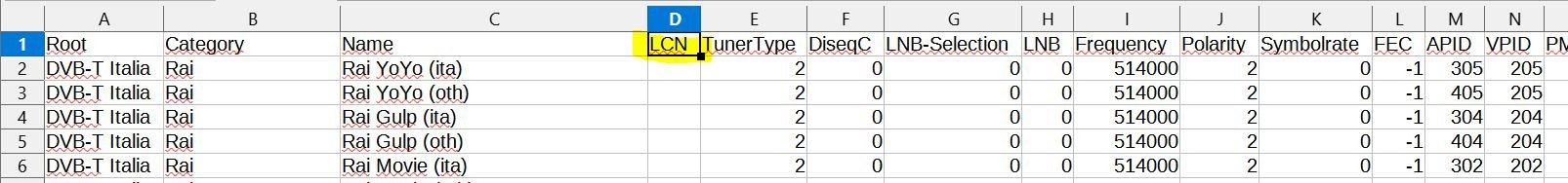

mame Posted February 20, 2022 Author Posted February 20, 2022 Ohhhh!!! Now I have all filters (x86 and x64) installed and can view at all scanned channels, thanks! I'd like to ask a new question (tell me if I must open a new topic): I'd like to get a channel list ordered by LCN but how to do? Exporting the channel list I can see the LCN field in the header row but it is empty, why? Quote
Griga Posted February 21, 2022 Posted February 21, 2022 Am 18.2.2022 um 23:48 schrieb mame: I am testing DVBViewerDemo before buying PRO Did you buy DVBViewer Pro in the meantime? Otherwise you will not be able to use LCN, because you need an additional scanner tool (TransEdit) for it. The LCN part is still under development. The latest TransEdit version which contains improvements particularly for Italian DVB-T (see here) has not been released yet. But it will happen soon... vor 6 Stunden schrieb mame: Exporting the channel list I can see the LCN field in the header row Where can you see it? Quote
mame Posted February 21, 2022 Author Posted February 21, 2022 4 hours ago, Griga said: Did you buy DVBViewer Pro in the meantime? Otherwise you will not be able to use LCN, because you need an additional scanner tool (TransEdit) for it. The LCN part is still under development. The latest TransEdit version which contains improvements particularly for Italian DVB-T (see here) has not been released yet. But it will happen soon... Not yet, I am still testing 4 hours ago, Griga said: Where can you see it? here, in the header row of the exported csv Quote
Griga Posted February 21, 2022 Posted February 21, 2022 vor 2 Stunden schrieb mame: in the header row of the exported csv I see. DVBViewer 7.2 including the demo version is prepared for LCN handling (see 7.2.0 change log), but not yet able to scan for LCN itself. It requires an additional tool, as already said. This tool is only available after buying DVBViewer Pro. All you can do for now is to enter the numbers manually in the DVBViewer Channel Editor. Quote

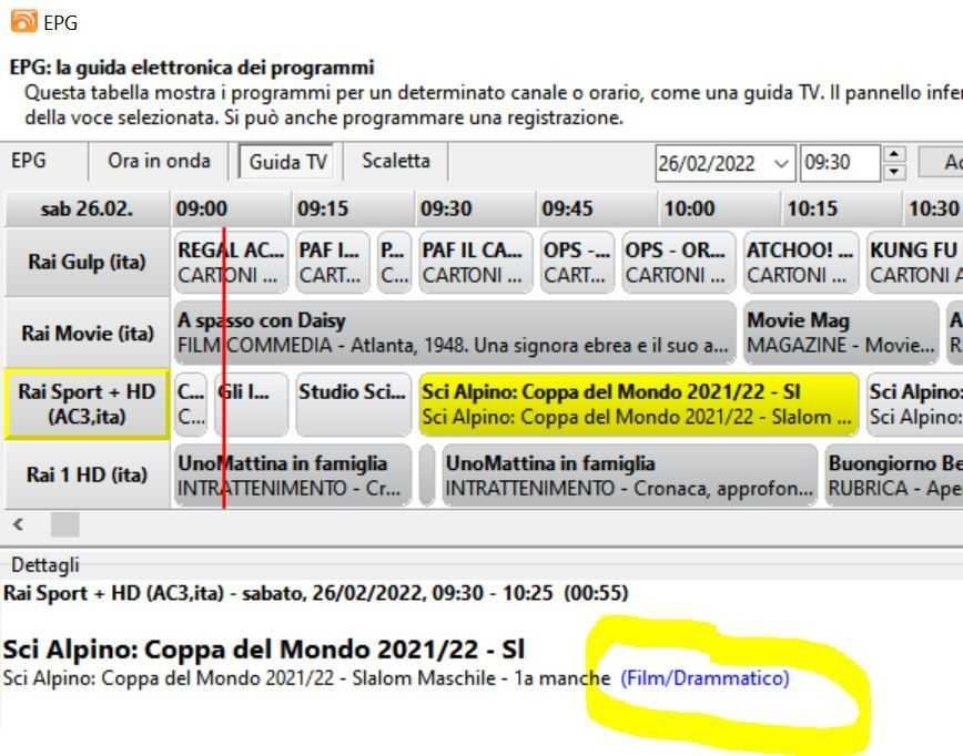

mame Posted February 26, 2022 Author Posted February 26, 2022 Well. A curiosity: where is the EPG information imported from? Here in this example, where it is an important ski race, the warning (Film/Drammatico) is highlighted in blue. It is surely NOT a movie and we hope it is absolutely NOT dramatic. Quote
Griga Posted February 26, 2022 Posted February 26, 2022 vor 1 Minute schrieb mame: A curiosity: where is the EPG information imported from? It is broadcasted by Rai. DVBViewer evaluates it according to the DVB specifications. See ETSI EN 300 468 V1.16.1 (PDF, easy to find in the internet), section 6.2.9: Content descriptor. Quote
mame Posted February 26, 2022 Author Posted February 26, 2022 6 hours ago, Griga said: It is broadcasted by Rai. DVBViewer evaluates it according to the DVB specifications. See ETSI EN 300 468 V1.16.1 (PDF, easy to find in the internet), section 6.2.9: Content descriptor. Evidently that site is not reliable, at least as regards the type of transmission. On no TV that I can verify, a sports broadcast is classified as "film" let alone "dramatic". Suggestion? Ok to view the broadcast, but without adding comments on its type! Quote

botti 56 Posted February 27, 2022 Posted February 27, 2022 Am 26.2.2022 um 09:22 schrieb mame: Here in this example, where it is an important ski race, the warning (Film/Drammatico) is highlighted in blue. Maybe those tags are quite arbitrary. The german ZDF tags a popular sports show as 'social, political and economic' and all these categories applies to sport. And yes, a ski race can be really 'drammatico'. Quote
