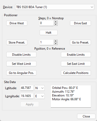

Griga Posted March 18, 2022 Posted March 18, 2022 Have you already purchased the DVBViewer full version? If yes, I would first try to move the motor with the TransEdit Positioner Console. TransEdit is a transponder list editor, scanner and DVB Analyzer tool. More about it in the manual. TransEdit can be downloaded from the DVBViewer customer area. Quote
il diavolo epm Posted March 18, 2022 Author Posted March 18, 2022 Thank you so far. I'll try it. Quote
il diavolo epm Posted March 19, 2022 Author Posted March 19, 2022 dead engine does not respond, no reaction Quote
il diavolo epm Posted March 20, 2022 Author Posted March 20, 2022 Positioner Drive West and Drive East have to shoot by hand, does Athens not move? Quote
Griga Posted March 21, 2022 Posted March 21, 2022 15 hours ago, il diavolo epm said: Positioner Drive West and Drive East have to shoot by hand Does this work with the "Drive West" and "Drive East" buttons in the TransEdit positioner console? Quote
Griga Posted March 21, 2022 Posted March 21, 2022 Please attach your TransEdit.ini (from the configuration folder) here as file, so that I can see some details. Quote
Griga Posted March 26, 2022 Posted March 26, 2022 I can see no problem in your TransEdit.ini. Your TBS 6590 has been detected correctly, so in theory it should work. There is something you can try. Open your TransEdit.ini with a text editor while TransEdit is closed, search for DiSEqCCount.1=1 and change it to DiSEqCCount.1=2 or even DiSEqCCount.1=3 Then save and restart TransEdit. This lets Transedit send every DiSEqC command two or three times. Maybe it helps to let your motor understand what it shall do. Quote

il diavolo epm Posted April 16, 2022 Author Posted April 16, 2022 On 26. 3. 2022 at 18:11, Griga said: Spíše bych zkusil najít odborníka s měřícím zařízením (DiSEqC monitor), který je schopen zkontrolovat, zda vaše TBS 6590 odesílá DiSEqC příkazy správně. HI, I want to ask the moderator. But my engine only works on the Drive West and Drive East positioners. I don't know how to set up a satellite position, automatically without success, but it's weird when it works manually on the console. I don't know a how to automatically find and search for a satellite ??? Thanks Quote

EnoSat Posted May 30, 2022 Posted May 30, 2022 On 4/16/2022 at 12:56 PM, il diavolo epm said: HI, I want to ask the moderator. But my engine only works on the Drive West and Drive East positioners. I don't know how to set up a satellite position, automatically without success, but it's weird when it works manually on the console. I don't know a how to automatically find and search for a satellite ??? Thanks Quote
il diavolo epm Posted June 1, 2022 Author Posted June 1, 2022 Ano vím o tejto konzole pozicionéru. Akorát ještě musím doseřídit a vyskoušet jestly fuguje správně. Protože větčinou po zadání se mě motor natočil uplně na jinou nesmislnou pozici. Quote
EnoSat Posted June 3, 2022 Posted June 3, 2022 (edited) Maybe problem with commands etc. motor:_______________________to the left (+ no. degrees)_________to the right (+ no. degrees) STAB and SM3D12______________Ex xx_______________________________Dx xx SG2100_______________________Ex xx_______________________________0x xx Geotrack H120 and generic____Fx xx (counting back from FF FF)____0x xx Edited June 3, 2022 by EnoSat Quote
