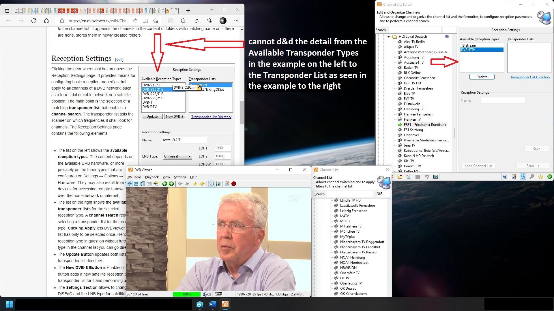

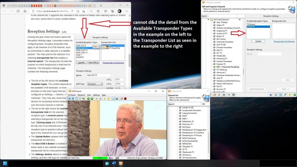

DVBViewer of the latest version 7.2.1.0 have been installed. Attempts to follow the detail as you sees in the snapshot [2205222] the transponders do not on d&d transfer to the Transponder List, so is a challenge to add these required transponders.

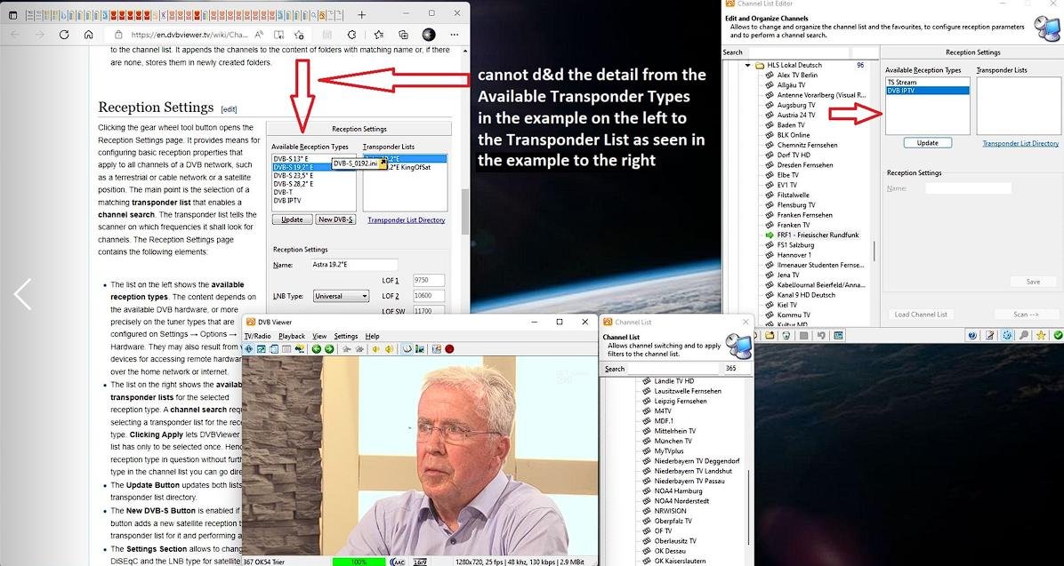

In 2205221 the attempt to d&d the Available Reception Types does not prevail only when to attempting to place them under the ARTs on the right of the picture can there be no transponder lists as shown in the example in the manual on the left.

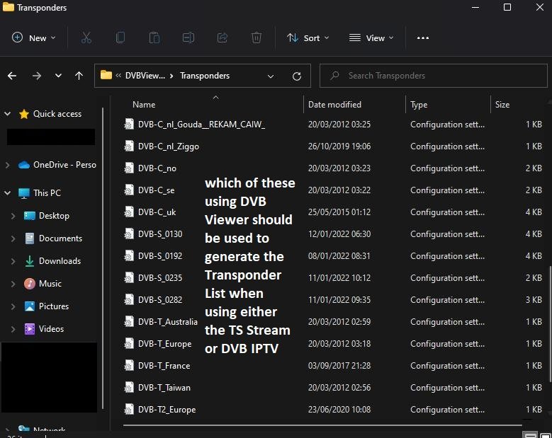

In 2205229 which of these available Transponders using DVBViewer should be used to generate the Transponder List when using either the TS Stream or DVB IPTV. The ability to receive television vis Satellite of Technisat MT exists where previously DVBViewer TE2 were used until not longer available under Windows 10 and now Windows 11 ; can this availability of reception via Technisat MT exist with either DVBViewer or DVBViewer TE2 and if so, could it be explained how access from such reception  from both may be made possible and what if any requirements are thier to ensuring the reception of channels from both applications DVBViewer and DVBViewer TE2
Reception Settings has thus a challenge to showing thier availabilities, the channel will only load from the TS Stream but not DVB IPTV, as also the Technisat Skystar2 HD Card should also present availabilities but thier needed to be such a possibility for this to happen, thus cannot the ability to Scan for Channels as The Transponder List cannot be loaded.

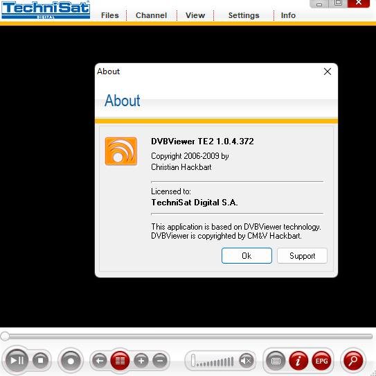

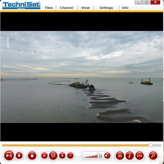

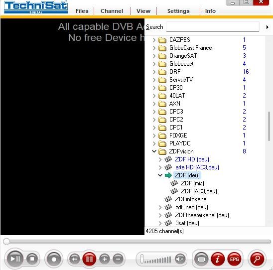

Next to the DVBViewer TE2, which were in successful operation for some times under earlier versions of up to Windows 10.
2205223 shows Techinsat DVBViewer TE2 installed.

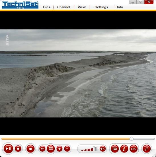

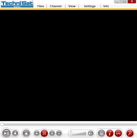

2205224 shows the selection of a channel.

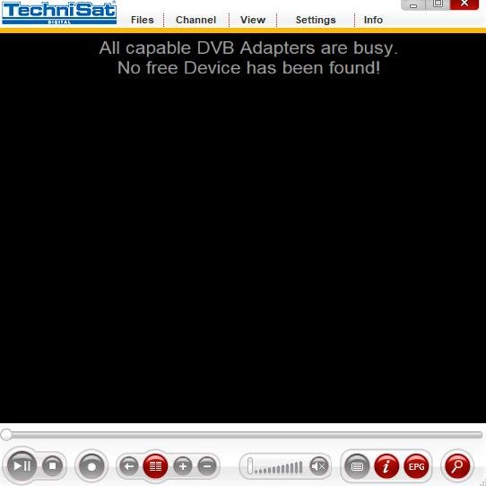

2205225 shows thier the availability of the DVB Adapter not being found.

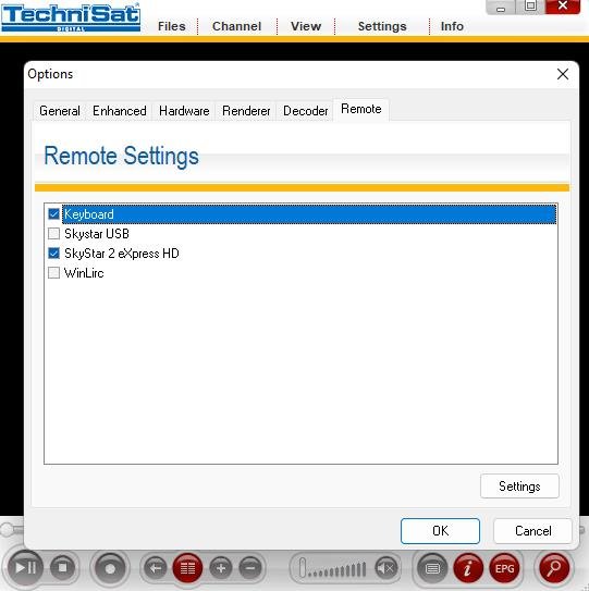

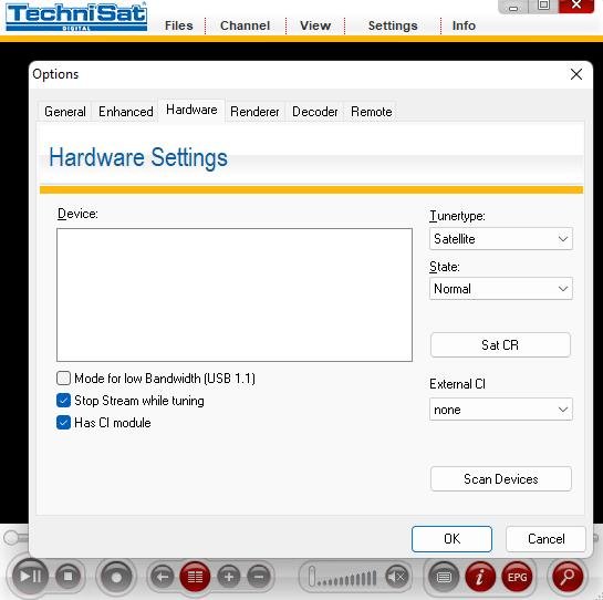

2205226 shows The Hardware Settings with the Device Description remaining empty despite the Device "having being installed" ; previously used via Satellite, the Device when "Scan Devices" is selected does not appear in the description
2205227 gives the availability to the SkyStar 2 eXpress HD Card being available, thier is no access to it as it is not featured.

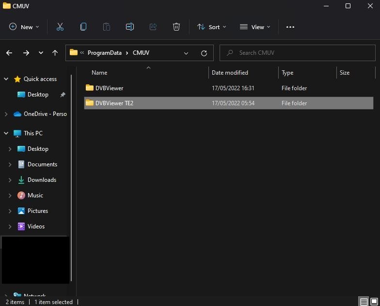

2205228 shows the detail of the DVBViewer being installed on the system, the latest version as observed of youerselves.
See the detail of which were observed at the link
https://www.DVBViewer.com/en/page=manual&chapter=b&sub=b1
but could not locate the ini file as mentioned in youer second paragraph under Prerequistes.

What is the exact product name of your TechniSat card? Unfortunately there are cards with similar names (SkyStar XXX...), but completely different hardware and drivers.
Please note that TechniSat has stopped the support for PC products many years ago, so there are no up-to-date drivers for Windows 10/11, and there is no guarantee that your card will ever work under Windows 11.

There are two drivers for this card contained in the TechniSat software download. One of them (NDIS) enables using the card as network adapter for internet via satellite. It is usable with DVBViewer, but not recommended. All what DVBViewer needs is a pure BDA driver installation. This is what I would try.
As far as I can see, the SkyNetNXPBDA.inf / SkyNetNXPBDA_AMD64.sys files are suitable for the SkyStar 2 Express HD. Maybe it is necessary to install the BDA driver manually (in the Windows Device Manager) and direct Windows to these files. After installation, devices with BDA driver usually show up in the  Sound, Video and Game Controllers section of the Windows Device Manager, without any network related stuff.
Without successful driver installation you won't be able to use the card in DVBViewer. So that's what has to be solved first.

Reading youer informations it were decided to check for a few things, on of the p/s connector of the card not being connected thier thus were no detection. On connecting the p/s of the card thus updating to the latest updaters, we're "cooking on gas" [it now works well and fine as you sees from the illustrations] with this post, so pleased am I for this for thier were no DVBViewer here since the onset of Windows 10 to this now the latest of Windows 11, I always enjoyed to use it so thanks once again for youer help, gratefully  appreciated.
Just this next point, the question of dragging the transponder information into the box as shown in the additional illustration : this d & d still not possible is as seen in the second picture of the first post, in the last picture of the first post, is thier something as you could suggests to make this possible, I'd likes to have receptivity from other channels available within the MT "ring" of "four" in DVBViewer Pro, would thier be a safe way to be able to do this direct via the MT as connected to the system ? Hopes you can assists on this one.

vor 6 Stunden schrieb ExtraNordinaut:

The goal is to be able to achieve transponder receptivity of all the satellite types availability of the Multytenne using DVBViewer Pro. So then d & d does not appear to be supported from the list as shown in the attached illustration. Using DVBViewer Pro, I wants to perform a channel search of
Eutelsat 13° East,
Astra 19,2° East,
Astra 23,5° East and
Astra 28,2° East but d & d "does not permit this"
What do I have to do to enable the d & d as illustrated in 22052210
Hope this is clearer for youer understanding and once again thanks for youer assistance !
with regards
vor 9 Stunden schrieb ExtraNordinaut:
That's easy, because the channel and transponder lists pre-installed with DVBViewer Pro are suitable for the Multytenne (I'm owning it myself). Proceed as follows:
  • On the Reception Settings page of the Channel List Editor select the desired satellite position in the Available Reception Types list. If it is not present yet (because there are no channels from this satellite position in your channel list), simply select DVB-S.
  • If the generic DVB-S item is not present, DVBViewer hasn't detected your TechniSat card yet. Click Settings -> Options -> Hardware -> Scan Devices, followed by Apply in the Options window and Update on the Reception Settings page.
  • Select the transponder list for the desired satellite position on the right side.
  • Click Load Channel List and select the channel list that DVBViewer shall load in the popup menu. Or click Scan if you want to perform a channel search.
Hallo Griga to this next update
Just now did youer suggestion, youer suggestion've worked, thanks, youer a star !

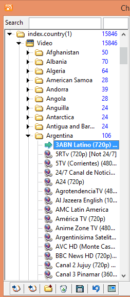

Hallo Griga, just following youer information and these are the results of what you were suggesting :
The .m3u file when selected will only stream via Windows Media player but has sporadic operation ;
When streaming via Windows Media Player, see the dots in the bottom middle in orange, the stream goes into a buffer zone with sporadic playback ;
Whether selecting playback of the .m3u file in either DVBViewer Channel Editor or via the dropdown menu options, select DVBViewer and nothing happens, perhaps this is needed for a different type of input ?

Don't try to play the m3u file or its URL. It is a playlist containing items that can be played. It's a kind of channel list. Let's take this one:
https://iptv-org.github.io/iptv/index.country.m3u
First download it so it is stored on your hard disk. Right click the link above and select "Save Target as". Then drag and drop the downloaded m3u file from an Explorer Window into the DVBViewer Channel List Editor. The result should look like this:
Then tune the channels.
Here it works with DVBViewer 7.2.2.
