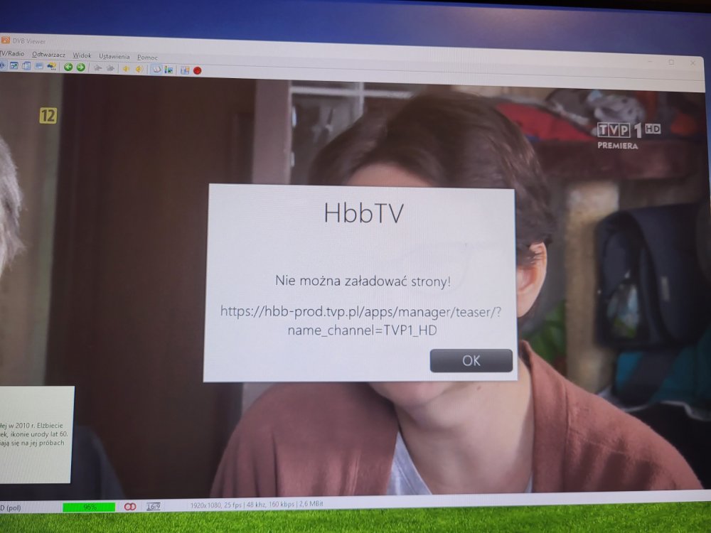

Good morning,
I would like to ask for help with the HbbTV plug. Unfortunately, once installed, it doesn't work. An error is displayed (photo attached) or the HbbTV page is not displayed on TVP channels. On Polsat channels, sometimes it works and it is possible to turn on HbbTV, but the content is not loaded. When disabling the firewall in ESET it also does not work.
We had another look at it, but unfortunately we are not able to fix it, because HbbTV is based on third party components. The possibilities to take influence on it in DVBViewer are too limited for getting this straight. Currently we are investigating if we can replace it by a new code base for HbbTV, but that will take some time.
So I think the HbbTV add-on in its current state shouldn't be sold to Polish users. I recommend to ask for refund.
