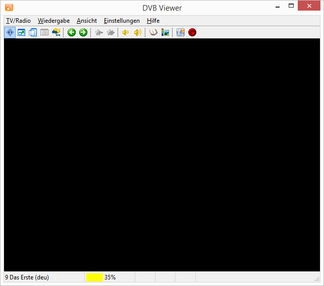

When I start DVBViewer or when it is runnung and I switch to another station, the station is correctly recognized but very often the stream is not displayed (dark screen) . After switching multiple times between different stations it works sometimes (stream is displayed correctly).
Any thoughts or similiar experiences?
Attached please find support.zip for the case when DVBViewer was started. Previous station is recognized but screens stays black.

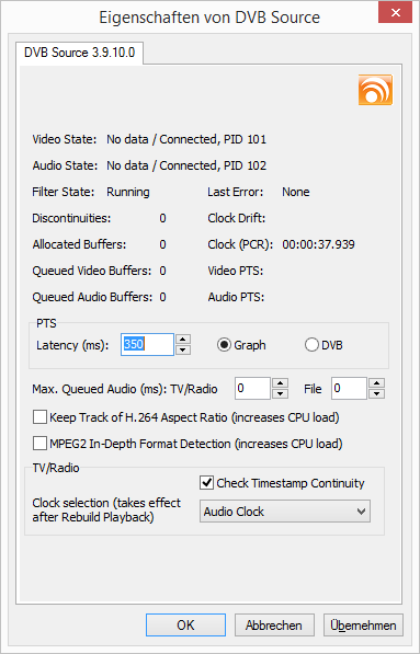

Anyway, another thing to check is the DVBViewer Filter Property Page. Does it display errors or an increasing number of discontinuities when the issue occurs?

Thank you for checking.  Here is the property page in case of error. Obviously no data is detected for Video and Audio
 image.png.5ab78a17a967cb7c09122028a0531597.png image.png.2193dd0e3004296bb630b5e1f9b83343.png

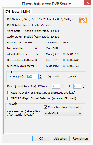

However after changing stations a few times it suddenly captures the station:
image.png.7ad1cda323a836b29039b7200bc20428.pngimage.png.94ce720271725d12bf2d0531c1372978.png
This usually means, DVBViewer doesn't get data at all from the DVB device driver. However, the signal doesn't drop to 0, but remains 35% no matter if DVBViewer gets data or not, which is a bit puzzling.

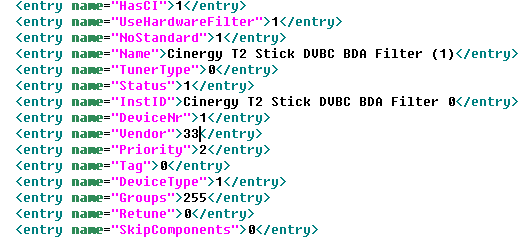

  • In DVBViewer select Help -> Configuration Folder (opens an Explorer window).
  • Close DVBViewer.
  • Open the file hardware.xml from the configuration folder with a text editor (Notepad).
  • Replace 28 in
<entry name="Vendor">28</entry>
in the first section for your "Cinergy T2 Stick DVBC BDA Filter" by 33 (which means "no special vendor specific handling")
  • Save and restart DVBViewer.
Does it change anything?
I did as you suggested:
Unfortunately, it didn't change anything.
Also, I observed that any station is shown with 35%, even if the TV cable is disconnected.
