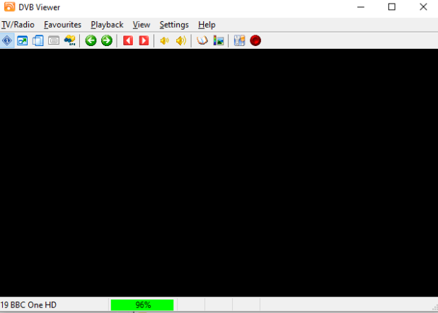

For the past 3 weeks I've been having problems where randomly channels will disappear (BBC1HD, BBC2HD) and basically work when they want to. Today for example BBC1HD was working this morning but now all I get is a blank screen, the signal shows around 96%.

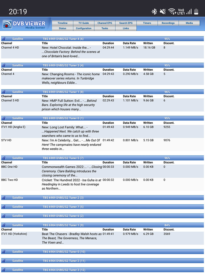

I set some timers last night to check and as you can see from the attachment, All 3 ITV1 channels were unwatchable and BBC channels didn't start (would randomly start through the night for a few minutes but than stop, the recording folder had about 1.5GB of multiple .ts files)
Any ideas as to what might be my problem please?
