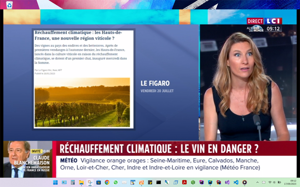

Hello,
I have a new computer, and I installed DVBViewer, but on this computer, with Win11, when I toggle DVBViewer to full-screen mode, I can see the background window (or desktop, with icon bar below), in 2 horizontal bars above and below the video being played...
Do you know what settings to change to make those bars black instead? I just would like to get rid of the distracting environment of my computer when watching TV.
Thank you 🙏
Which Video Renderer do you use? Check Settings -> Options -> Playback Components -> Video -> Video Renderer. Replace EVR Custom Video Renderer by EVR Enhanced Video Renderer or vice versa. Does it change something?
The other Renderers are not really suitable for Windows 10/11, because they prevent hardware accelerated video decoding, but for testing you can give them a try...
Thank you! Indeed, using EVR Enhanced Video Renderer did the trick 😉👍
