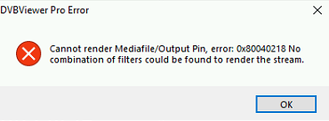

Alan_SP Posted February 29, 2024 Posted February 29, 2024 (edited) What I did: I have copied configuration from the old computer, where it worked (and I have there older version 7.0.1.0/3.0.1.0). On a new computer I have installed latest version (7.2.5.0/3.2.5.0) after I have copied old configuration to save myself from searching for channels and doing other configuration things. From my initial testing, Media server is able to save programs, but when I try to run Viewer, there's error (as on image). Not sure what it means, and how to solve this issue. I tried reinstalling Viewer, and it still doesn't work. Edited February 29, 2024 by Alan_SP Quote
Alan_SP Posted February 29, 2024 Author Posted February 29, 2024 I have found out, I didn't have HEVC codecs installed, as it's a new computer, so I have installed LAV codecs: https://github.com/Nevcairiel/LAVFilters/releases This now works, but I have another strange issue: Now, when I open DVBViewer for the first time, I get message that "Channel is not available from server", and there's no picture. But, when go to channel list, and choose any channel, including the one "that's not available from server", it starts to play. Really confusing. It works, but not from the start. Configuration worked on old computer (but on older DVBViewer/Media server version). Quote

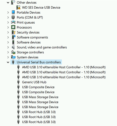

Griga Posted March 6, 2024 Posted March 6, 2024 vor 8 Stunden schrieb Alan_SP: if I want to save channels information, I only need to save channels.dat file? channels.dat favourites.xml (if present, your favourites) ChannelsURL.ini (if present, required for channel list entries with a file path or URL, Internet TV/Radio, streams etc) DiSEqC.xml (if present, may be required for satellite channels in certain cases) vor 6 Stunden schrieb Alan_SP: It does seem, at least at the moment, that the issue was something with that USB2 port. You may want to check your chipset / USB drivers in the device manager. Are legacy Microsoft drivers installed, or drivers from the manufacturer? Does it provide updates? Quote
Alan_SP Posted March 6, 2024 Author Posted March 6, 2024 (edited) Thanks for info about saving channels information. About chipset and USB drivers, I have installed what I was offered from support page for my motherboard and looking at USB in device manager, everything seems okay, from what I can tell. Only device that has issue is WD disk, which works properly, and I did tried to update driver for it, but there were no results for it. Edited March 6, 2024 by Alan_SP Quote
