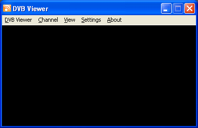

I've a weired problem after upgradeing to DVBViewer 3.1 :
The thing does not seem to startup correctly. All i get is a minimized window in the topleft corner. When i try to maximise it, i can't see any program icons and also it looks like only a rudimentary skeleton of the program is running and waiting for something to happen. Yes i know dodgy description. I attach two images, which illustrate the problem.

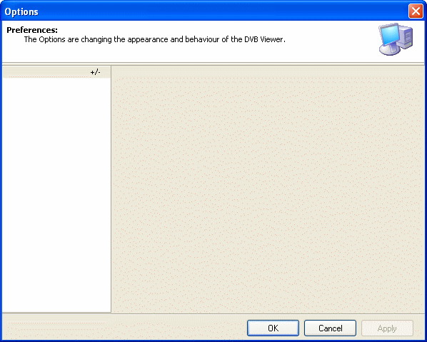

@Klausing: I cannot setup anything, because the half-started up & hung DVBViewer 3.1 app. has a options menu like that:
