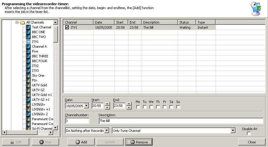

1) The main problem is that clicking on the record icon does not start an instant record event. Instead if I look in the schedule, there is an item for the channel I just pressed record on, with the message "Waiting" in one of the boxes (see attached screenshot).

1.) have a look at the lower right dropdownbox. you have "Only tune Channel". do you have set this as a default action in the options?

1) Thank you and an added :) for me not realising this. You must love us n00b's ;)
