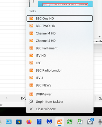

recently updated Windows 11 to 24H2 so a variety of changes took place.
One thing that has stopped working is the ability to launch DVBviwer via pinned channel list on the taskbar. Launching DVBViewer via taskbar works but doing it via any of the channels has stopped working after 24H2 update. I have downloaded and installed 7310. So I click on a channel on the list an nothing happens.
Jumplist:
[Jumplist]

BBC One HD =-x53 "-c:3713288830490133636|BBC ONE HD"
BBC TWO HD =-x53 "-c:3713288830064149568|BBC TWO HD"
Channel 4 HD =-x53 "-c:3713288830077256960|Channel 4 HD"
Channel 5 HD=-x53 "-c:3713288830477026624|Channel 5 HD"
BBC Parliament=-x53 "-c:3713235778660864640|BBC Parliament"
ITV HD=-x53 "-c:3713288830070703300|ITV HD"
LBC =-x53 "-c:6019149139524016480|LBC"
BBC Radio London =-x53 "-c:6019078788044953604|BBC Radio London"
ITV 3 =-x53 "-c:3713253100375384166|ITV3"
BBC NEWS =-x53 "-c:3713235778654310656|BBC NEWS"
talkSPORT =-x53 "-c:6019149139471587392|talkSPORT"
Not a big problem but probably a setting somewhere.....
btw Have been using DVBViewer for 10 years+ I think...great  product

Hi Griga, .exe works fine and everything OK. Shows two lines on the jumplist as per the jumplist file but nothing happens even when you click on an entry and select open.
btw that was the case also for the 7.3.1.0
Have done a clean setup ( removed all folders from previous including CMUV folder)
enclose jumplist.ini and a screenshot
jumplist.ini

Hi Griga, both the taskbar & start menu jumplist react the same.
Recently Used: The files opened recently in the list work...ie when you click on them they launch DVBViewer.
The Channels listed  in both taskbar & startmenu jumplists do not work. I have jumplist with just 3 channels, 2 just have channel ID and 1 channel with a "-x53".
Similar jumplist exist in Microsoft excel (and other office products)....where you can pin files and that works, not sure if they use the same mechanics.
I only have Windows 11 so cannot test Windows 10. The problem started when I upgraded Windows 11 to 24H2 from 21H2.
