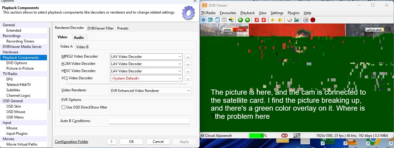

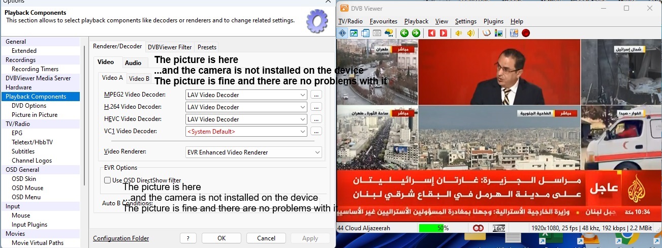

الهاوي Posted March 13 Posted March 13 (edited) The picture is here and the CAM is not installed on the device... The picture is fine and there are no problems with it The picture is here, and the CAM is connected to the satellite card. I find the picture breaking up, and there's a green color overlay on it. Where is the problem here? Edited March 13 by Griga camera -> CAM correction Quote
Griga Posted March 13 Posted March 13 vor 28 Minuten schrieb الهاوي: I find the picture breaking up, and there's a green color overlay on it. Where is the problem here? The CAM seems to corrupt the TV stream received by DVBViewer. Is the "Encrypted" checkbox for this channel checked in the DVBViewer Channel Editor? The stream of a channel that is not flagged as encrypted should not pass through the CAM. Quote
الهاوي Posted March 13 Author Posted March 13 All channels appear blurred and green... When the camera is installed on the device Quote
الهاوي Posted March 15 Author Posted March 15 When I connect the cam to the device, all the open channels appear distorted. Is the problem with the filters, where is the problem? Quote
Griga Posted March 15 Posted March 15 vor 17 Minuten schrieb الهاوي: Is the problem with the filters, where is the problem? I think it's a problem with the CI and CAM not working properly together. Check the DVBViewer Filter property page. Does it display an increasing number of discontinuities? If yes, the stream received by DVBViewer is already disturbed. Quote
الهاوي Posted May 13 Author Posted May 13 (edited) Am 15.3.2026 um 09:05 schrieb الهاوي: عندما أوصل الكاميرا بالجهاز، تظهر جميع القنوات المفتوحة مشوهة. المشكلة في الفلاتر، أين المشكلة؟ his picture is of an Irdeto Access CI+ CAM from the Irdeto company. And this is exactly the reason for the problem I mentioned. Why it doesn't work with TT-3650 CI: 1. CI+ CAM and CI card only TT-3650 supports only CI 1.3. The Irdeto one in the picture is labeled CI+. CI+ and CI 1.3 are different protocols. When you insert a CI+ into a CI card, a conflict occurs and you get the green screen and freezing even on open channels. 2. The CAM always works even if the channel is free The Irdeto CI+ CAM forces itself on the card and demands encryption even if the channel is FTA. TT-3650 doesn't understand this request and the decoder gets messed up, which is why you see green colors and breaking. 3. Draws extra power CI+ CAMs draw 0.5A. The USB port of TT-3650 provides at most 0.5A, so the CAM heats up and causes problems. The proof that the problem is from the CAM: You said yourself: 'When I remove the CAM, the open channel works without problems.' If the problem were from the card or the driver, it would still be there even after removing the CAM. Since it disappears when you remove the CAM= the CAM is incompatible. Edited May 13 by Griga Replaced camera -> CAM 1 Quote
