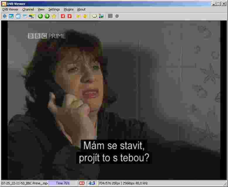

well i just tested it and everything seems to be fine. I'm not quite sure, but the playback with enabled dvbsource filter as source causes some smaller problems. Anyhow using ordinary dshow runs fine - like the screenshot explains :)
