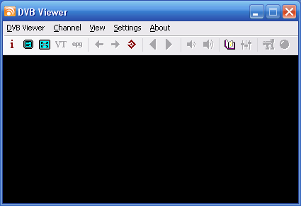

until recently DVBViewer worked correctly, but since restarting my pc, DVBViewer (version 3.2.3) doesnt seem to load right.
after loading the window looks like this:
i can make it larger with the mouse, but the screen remains black. i tried to enter the settings, but all i can see is this:

i also attached a screenshot of what the window looks like, after i enlarged it. the toolbar seems to have different icons than before.

Did you enable data execution prevention?
There is a mysterious bug in DVBViewer Pro (or in one of its components) that causes an access violation if Athlon 64 NX bit usage is enabled for all software and, as a result, the issue described above.
Rightclick MyCcomputer -> Properties -> Advanced -> Performance -> Data Execution Prevention -> click Add to add DVBViewer.exe to the list of programs that are excluded from DEP.
Read more about it here:
http://support.ipswitch.com/kb/WS-20050719-DM01.htm
it worked!
that solved the problem! thank you very much!
