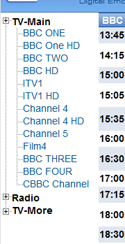

Cian Posted July 12, 2012 Posted July 12, 2012 I asked this question on a different thread and got this answer as a possible workaround. It means that instead of editing a favourites list, you create a new Root folder (like the one that is automatically generated when you run a scan) and copy your favourite stations into this folder. That way, it becomes the first folder that the Recording Service web interface sees. It also means that things like the PS3 will see your "Favourites" folder in the same way that they see the "Provider" folders at the moment. It goes as follows: There is no favourites support in the RS and if you like the DVBViewer to use favourites everywhere you have to change approximately 16 settings. Personally I wouldn't use the favourites at all. In my opinion the better way is to sort the beginning of the channel list. 1. create a new Root folder: open the Channel list Editor > select a channel > change the "Root" name to "favourites" [> change the Category name as well] > klick on Apply 2. move the Root folder via drag and drop to the top of the channel list 3. move ale your favourite channels via drag and drop in the favourites folder 4. export the sorted list as a backup > select the favourites root Eingefügtes Bild save. 5. use TransEdit for updating the channel list It is a little awkward at first, but no more awkward than sorting the favourites list in DVBViewer.
