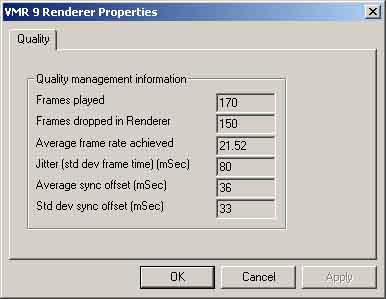

This is what VMR9 property page says about the OSD connected to input pin 1:
I'm wondering whether this is as it should be.
Link to post
no for sure... it shouldnt
it should look like this

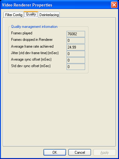

Very interesting finding indeed:
When watching DVB-S2 H.264 channels with <unchanged> video renderer selected looks like VMR7 in used.
But now the filter chain is perfectly synchronized.
This is great, but I really would like to know why this VMR7 mode works and the other does not?
Link to post

Would somebody be so kind and post a picture of VMR7 property page after watching any normal channel for a while with VMR7 renderer (View -> Filters -> VMR 7 Renderer -> Quality).
This is what I would like to see:
and this is what I see with my system:
