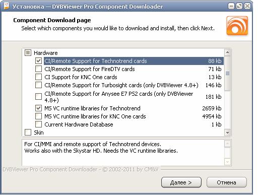

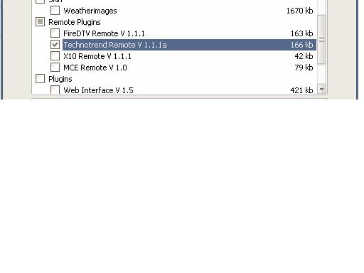

OllieW
Hi velti,
you also need to install the "CI Support for TechnoTrend cards" even if you don't have a CI module! Unfortunately this second plugin can't be downloaded from the "DVBViewer Members Download Page" (I don't know why, but perhaps Hackbart or Lars can tell or add this addition plugin on the download page?!), so you have to do the download with the installation script...
I've attached a JPEG where you can see what to do! This is also mentioned in the decription of the "TechnoTrend Remote Plugin" at the installation (see attached JPEG), but nothing about this in the readme of the remote plugin...
After the installtion you have to start DVBViewer and go to "Settings-Options-Input-Inputplugins" and select "TechnoTrend Remote" and also go to "Settings" and select the "TechnoTrend BDA/DVB-x Tuner" device! Now you can make DVBViewer "learn" all the remote keys...
Greetings,
OllieW

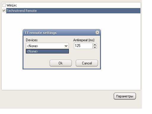

Yosef
Hi guys.
I have read many forums and this forum also but still have problem to use IR remote with DVBViewer.
I have TT S3200 and XP SP3.
The remote works - checked by cell phone camera.
It even somehow works with ProgDVB.
But I like DVBViewer and want to keep using this program.
After I did everything step by step according to the first post at "input plugin - properties" in TT Rmeote settings appears <None>.
Share this post
Link to post
Tjod
Have you installed the Plugin via DVBViewer Pro Downloader (start menu)? This should install all required files.
Share this post
Link to post
Yosef
First of all thanks for your fast reply.
I installed the remote plugin via Pro Downloader menu and finally TT Device appeared instead of <None>.
But the remote doesn't do anything (despite the LED inside the remote emits). DVBViewer doesn't respond to any pressed button.
Do I have to tweak or teach it first?
Additionally after installing "CI/Remote Support for TT cards" & "MS VC runtime libraries for TT" & "TT Remote V 1.1.1a"
by DVBViewer Pro Downloader when I enter the same manu again it appears as nothing was installed and all boxes unchecked!
Thanks again.

HaraldL
Yes, you have to learn every key before something happens. I don't know if there are ready to use config files, I assigned all keys I need and it works fine.
Same here every time, obviously this is intended.
Share this post
Link to post
Yosef
Thanks a lot guys.
Special thanks HaraldL and Tjod!
After I learned all buttons the remote works well.
Share this post
