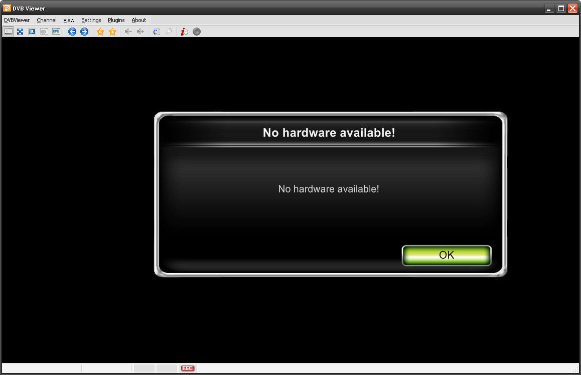

smallant Posted June 29, 2008 Posted June 29, 2008 Why DVBViewer can't found the hardware after the following steps: hibernate -> Auto bootup by service -> recording -> hibernate -> bootup manually -> Run DVBViewer (Show can't found hardware)
wwkwoo Posted June 29, 2008 Posted June 29, 2008 (edited) Hello, I am user from Hong Kong, I have same problem like samllant DVBViewer with Recording Services Beta sometimes cannot start normally, then when I start the DVBViewer again, It always say "Cannot found the hardware" and the recording job cannot start. Edited June 29, 2008 by wwkwoo
smallant Posted June 29, 2008 Posted June 29, 2008 (edited) What is the red color of tray icon? I found that I the red icon is displayed, the web interface service will be held and the service couldn't be restart by control Panel. Of course the recording job can't be started. Edited June 29, 2008 by smallant
Lars_MQ Posted June 29, 2008 Author Posted June 29, 2008 red does mean recording. Before we do any more guessing, I suggest you post a support.zip there is the log of the service in it and I may be able to see what is going on.
smallant Posted June 30, 2008 Posted June 30, 2008 (edited) red does mean recording. Before we do any more guessing, I suggest you post a support.zip there is the log of the service in it and I may be able to see what is going on. Here is my support.zip file, thanks for your help! (I truncated the log because it is too large) Edited June 30, 2008 by smallant
Lars_MQ Posted June 30, 2008 Author Posted June 30, 2008 well from the looks of it: one time the device was most likely used by another software and could not be used by the service and the last entries show, there simply was no device (may be driver related or it was not connected, don't know).
smallant Posted June 30, 2008 Posted June 30, 2008 well from the looks of it: one time the device was most likely used by another software and could not be used by the service and the last entries show, there simply was no device (may be driver related or it was not connected, don't know). Thank you for your fast response!

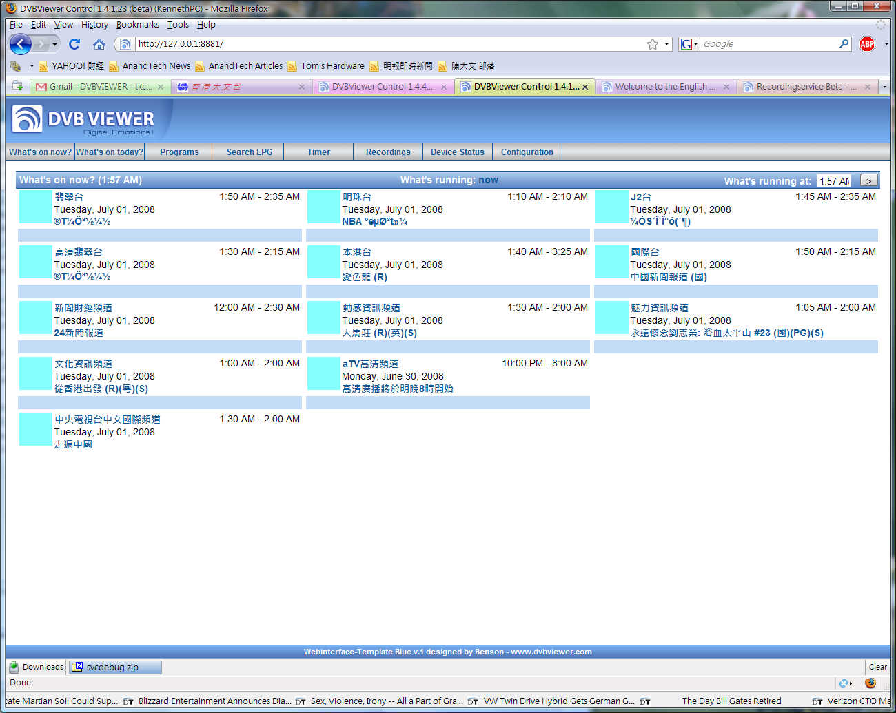

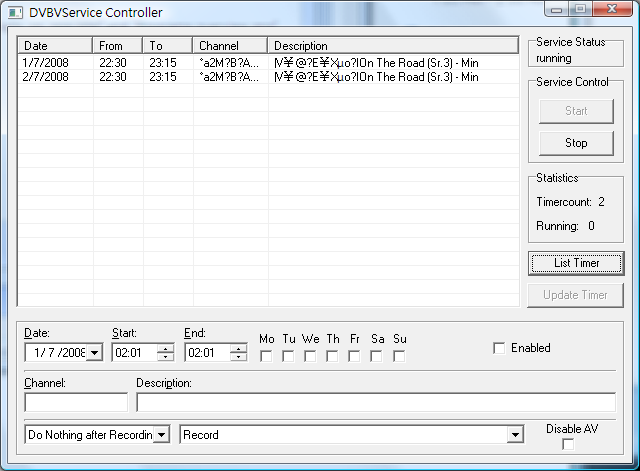

tat_keung Posted June 30, 2008 Posted June 30, 2008 (edited) Now using Vista with HTTP server 1.4.4 without any chinese problem. On recording service 1.4.1.23(beta), there's some error in showing chinese 1. if set language="Chinese (Traditional)", can't show chinese words. See "Chinese (Traditional).png" 2. if set language="chinese", 3 problematic pages show partial chinese words. See "Whats_on_today.png", "Whats_on_now.png" and "Programs overview.png" for reference. 3. Can't show chinese in DVB Service Controller, see "DVBServiceController.png" Edited June 30, 2008 by tat_keung
Lars_MQ Posted June 30, 2008 Author Posted June 30, 2008 Did I miss something or are the images missing? 3. this won't change in the near future, because it would mean a complete rewrite of this "byproduct". It was primarly a quick hack for testing purposes and I though maybe someone might use it now and then. I didn't think t would be used this much (I myself use only the webinterface). /edit ok now I see pictures.
tat_keung Posted June 30, 2008 Posted June 30, 2008 Did I miss something or are the images missing? 3. this won't change in the near future, because it would mean a complete rewrite of this "byproduct". It was primarly a quick hack for testing purposes and I though maybe someone might use it now and then. I didn't think t would be used this much (I myself use only the webinterface). /edit ok now I see pictures. Is there any other method that I can post more <800Kb images here?
tat_keung Posted June 30, 2008 Posted June 30, 2008 Now using Vista with HTTP server 1.4.4 without any chinese problem. On recording service 1.4.1.23(beta), there's some error in showing chinese 1. if set language="Chinese (Traditional)", can't show chinese words. See "Chinese (Traditional).png" 2. if set language="chinese", 3 problematic pages show partial chinese words. See "Whats_on_today.png", "Whats_on_now.png" and "Programs overview.png" for reference. 3. Can't show chinese in DVB Service Controller, see "DVBServiceController.png" Please get all images here, thx! https://download.yousendit.com/FA1EBAD84D64CBBD
Lars_MQ Posted June 30, 2008 Author Posted June 30, 2008 I see your point. But I have no real clue why it happens. The code is in principle the same in both application. The only difference is, the DVBViewer runs in your useraccount with all your (windows)settings and the service runs in a systemaccount (with only MS knows which settings). So if there are epg entries transmitted with incorrect language settings, the code tries to use the (windows)usersettings and I guess that's the problem. Is it always wrong shown for the same channels? If yes this might e a hint in this direction. Does maybe this help? It could be a similar problem...

tat_keung Posted July 2, 2008 Posted July 2, 2008 I see your point. But I have no real clue why it happens. The code is in principle the same in both application. The only difference is, the DVBViewer runs in your useraccount with all your (windows)settings and the service runs in a systemaccount (with only MS knows which settings). So if there are epg entries transmitted with incorrect language settings, the code tries to use the (windows)usersettings and I guess that's the problem. Is it always wrong shown for the same channels? If yes this might e a hint in this direction. Does maybe this help? It could be a similar problem... Problem 2 solved by applying all setting in HKEY_CURRENT_USERS\Control Panel\International to HKEY_USERS\.DEFAULT\Control Panel\International. For problem 1, there's no urgence since I can use english as interface while content now in chinese. However, GUI (not in web browser) still can't show the program name in chinese. (Problem 3 in #94, second pic)
tat_keung Posted July 2, 2008 Posted July 2, 2008 Problem 2 solved by applying all setting in HKEY_CURRENT_USERS\Control Panel\International to HKEY_USERS\.DEFAULT\Control Panel\International. For problem 1, there's no urgence since I can use english as interface while content now in chinese. However, GUI (not in web browser) still can't show the program name in chinese. (Problem 3 in #94, second pic) In addition to problem 3, the recorded .ts file also in strange character other that chinese.
