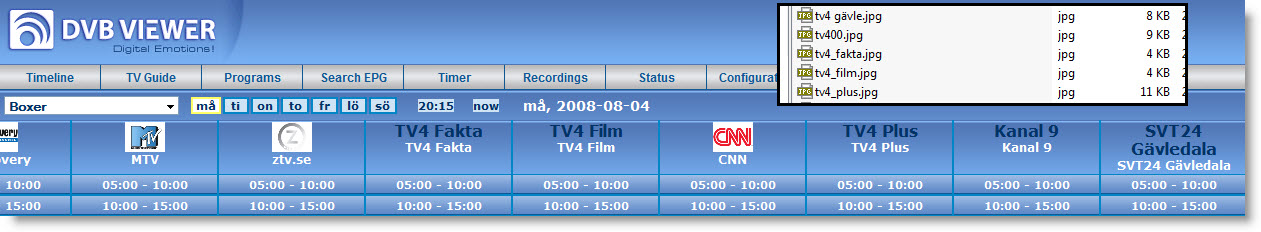

smallant Posted August 3, 2008 Posted August 3, 2008 The Chinese channel name can't show correctly in Timeline and TV Guide Tab. The attached screens are below: http://img176.imagevenue.com/img.php?image...d_122_506lo.jpg http://img239.imagevenue.com/img.php?image...2_122_228lo.jpg
Lars_MQ Posted August 3, 2008 Author Posted August 3, 2008 Damn it, I thought I got all the calls removed causing this. I've uploaded a hotfix to the membersarea, just download it again. Sorry about this!

IRa Posted August 6, 2008 Posted August 6, 2008 It appears if there is a space in the channel name the logo will not be displayed.Also if there is a "+" in name it is not shown. (OSD and EPGPlus shows them alright. )
