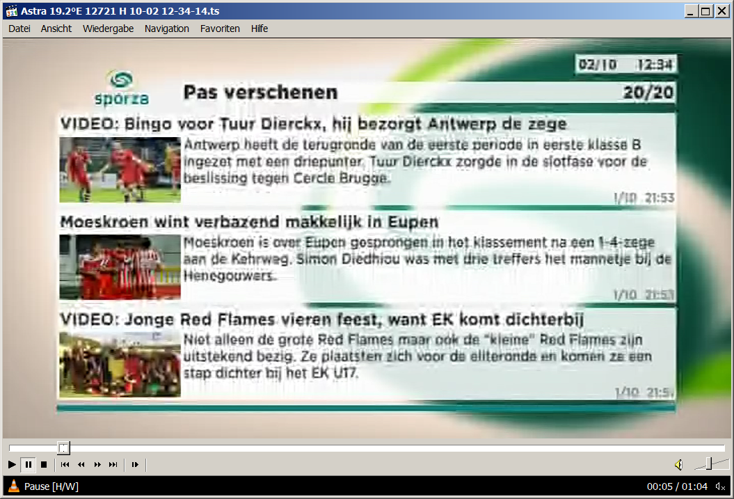

Working preview undefined video stream from TS ?
etc. videopid 32 and 33 on 12722H/19 East
after preview , show only black window (test with LAV and MS-DTV codec in 4.1.2 and 3.9.8)

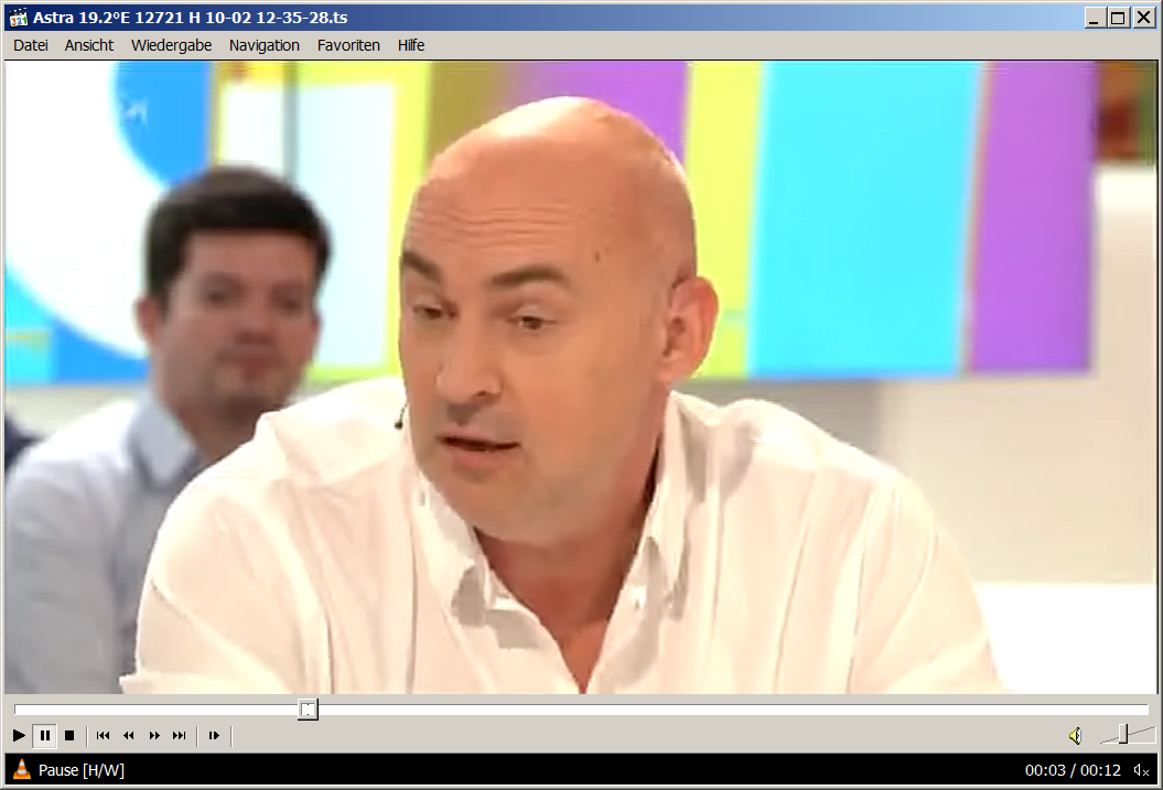

..use another player :) It seems to be a flemish program. But what is the use with no audio?
The Analyzer doesn't know the format since there is no PAT/PMT entry, so the Preview assumes MPEG2 video as default, which is wrong. That's why it doesn't play in TransEdit. The Header Info shows that it is H.264.
You can record the video stream with TransEdit and play it in DVBViewer (also while it is recorded).
maybe added info from Header info for detect Preview ?
