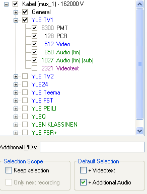

Jukka
Seems to be working fine, so give it a try. Select the channel in the channellist window, go to the Edit Tab, replace the audio PID by the subtitle PID, rename the channel to ... (sub), click "Add". Repeat this for all channels with a known subtitle PID, but never tune them, close DVBViewer, launch it again, and the VRPlugin should display the subtitle PIDs as additional audio PIDs, so you can select them on the Channels Tab for recording.
Hi. I followed these instructions and got subtitle PID as additional audio PID and selected it. But Tsplayer don't recognize this. It shows only video and audio (pic_1) and in record-folder there is only one file, .ts file.
Edited by Jukka
Share this post
Link to post
Klausing
set PID as Additional PIDs and it will work
Share this post
Link to post
Jukka
I tried this but it doesn't work. Still situation is the same as pic_1 and pic_2. PID number is right (1027) and is set to "additional pid".
Share this post
Link to post

Currently the only way to get teletext subitles working in timeshift in my system is to start recording with VRPlugin and then immediately start watching the recording with DVBViewer. That works but is a little bit complicated with remote. Is there any easier way to do the same thing? There seems not to be a way to get DVBViewer to use VRPlugin in timeshifting.

In the new 3.2.3 if I select Videorecorder for recording in the DVBViewer recording options, recording does not start either from the DVBViewer recording button or from the VRPlugin. Actually the VRPlugin start button is "grey" and not selectable. Recording without VRplugin is working OK.
