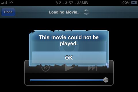

ml 05019 Posted February 8, 2010 Posted February 8, 2010 (edited) I've uploaded .85. Please test with non Ansi filenames and iphone streaming. Sorry, no luck: trying to play file: 01-01_14-03-39_LTV7_Mf Noīrēt tēti.ts getting in logfile: FFMPEG e:\MYVIDE~1\RECORD~1\отрывки\01-01_14-03-39_ltv7_mf noiret teti.ts: no such file or directory It looks like Webinterface replaces unicode symbols to similar letters (e.g. ī -> i) not only in EPG data, but also in filenames. Lars, could you just remove this feature? Since there's no encoding issues in Webinterface, I see no reason why symbols should be swapped, plus, it cripples the language. I also checked how filenames without non-ansi symbols are handled, and I could play them, but there's another issue with some of the files: I cannot select quality preset before starting stream, plus, if I reload the page, the styling disappears. But still, it streams Here's the logfile: (times shown on screenshots above are relevant to those in logfile) Edited February 8, 2010 by ml 05019
Lars_MQ Posted February 8, 2010 Author Posted February 8, 2010 OK was worth a try. Seem shortnames does not help. I have not been able to send files with unicode filenames to ffmpeg. if you open cmd.exe (dosprompt) can you start ffmpeg manually with this file (with a simple commandline, doesn't really matter what). And it seems your CPU can't handle the transcoding. You need constant 50 fps in transcoding, but it goes down to 33...

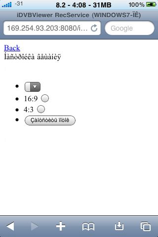

Lars_MQ Posted February 8, 2010 Author Posted February 8, 2010 BTW how do you swap out: 怎样才能在(just some random text I use for unicode test, I don't know where I got it or what it means) for ansi chars?
ml 05019 Posted February 8, 2010 Posted February 8, 2010 (edited) I knew you will be asking it add a toggle in settings so Chinese users can disable it users like me could enable it! What is more, this swapping is already being done for EPG in Webinterface (remembering what subforum are we in), so it's not something new I ask you to write. P.S. http://translate.google.lv/#auto|en|%E6%80...%83%BD%E5%9C%A8 Edited February 8, 2010 by ml 05019
Lars_MQ Posted February 8, 2010 Author Posted February 8, 2010 Actually this swapping is done because I haven't had the time nor the energy to convert the webtemplates and the code behind to utf-8. It would also required the language files to be changed, the search stuff and several other things. Most parts are unicode aware now in the service, the webinterface is the last thing I have to change and I'm not looking forward to it, because I'm not exactly the html expert. And you have to remember there is only one person working on the DVBservice and everything around it, me and there is only so much I can do at once...
