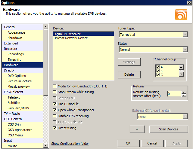

aht961 Posted February 23, 2010 Posted February 23, 2010 (edited) If I understand correctly in iPhone I need to introduce http://192.168.2.37:PORT_NUMBER/iphone. The problem is that I don't know what is the PORT_NUMBER I need to enter here. I entered all the ports but no one seems to be ok. Check the image capture attached. Look at the port indicated with "pink". That is the one you should include in your Safari's URL. E.g in your case: http://192.168.2.37:PORTNO/iphone. In order not to mix up everything, leave all ports at default and the "empty" slots empty! I have a tryutil of DVB Service V1.5.0.89 (beta) running. Is this necessary or not? It should be running. Remember also: 1. To disable the tuners through the DVBViewer's Options (DVBViewer client on the very same host PC where the Recording Service is running). Instead choose unicast tuners. 2. Look at the second image where the settings for the server are. Leave everything at default, don't change the ports. Tick the proper options, don't forget to activate the uPnP server! 3. If you are going through the router (WAN => LAN), you should use port forwarding (inbound/outbound) 4. On the client computer (if you need one), you should configure the DVBViewer client by choosing the unicast devices and configuring them. During this you should use the unicast device's properties you have seen in the second image above. If you tick "the automatic detection" and leave the port 600 untouched, the recording service will broadcast itself at your LAN and you should see it when you will be configuring the unicast device at your client DVBViewer. 5. Remember to enter the username/password. 6. When using the webinterface at the same computer where the RS in installed 127.0.0.1 will be enough. If you are using another client computer (iphone, laptop whatever), you should use the IP of your host computer, eg: 192.168.2.37:PORT_NUMBER. This PORT_NUMBER is the same as above indicated with pink. PS: Images are in Finnish, though Edited February 23, 2010 by aht961
raducoc Posted February 23, 2010 Posted February 23, 2010 @aht961: Saludos desde Espana Thanks for your detailed informations. I hope will work this way. "1. To disable the tuners through the DVBViewer's Options (DVBViewer client on the very same host PC where the Recording Service is running). Instead choose unicast tuners." If I understand correctly, I need to delete "Digital TV Receiver" from DVBViewer/Options/Hardware"? "3. If you are going through the router (WAN => LAN), you should use port forwarding (inbound/outbound)". No, I'm using a plain Ad-Hoc PC-iPhone connection. i can stream content with AirVideo without problems. This is what looks like in my Opera browser when accessing Recordings menu and clicking on Stream button: Nothing happens. I cant see any recorded videos. I need VLC or WindowsMediaPlayer to run or a plugin in browser? Also about FFMPEG. I extracted all the archive of ffmpeg-18639.7z directly into the root of DVBViewer directory where also I extracted DVBRecordingService_1.5.0.89.zip. I this the correct way to install?
Lars_MQ Posted February 23, 2010 Author Posted February 23, 2010 The streaming to the iphone is completely different. Please use http://yourip:yourport/iphone/ . Do not confuse the webinterface for the big screens with the webinterface for a mobile device. You can use the iphone streaming feature only on a iphone/ipod touch.
aht961 Posted February 24, 2010 Posted February 24, 2010 (edited) If I understand correctly, I need to delete "Digital TV Receiver" from DVBViewer/Options/Hardware"? That is correct. You don't need to delete it just choose "don't use it" This is what looks like in my Opera browser when accessing Recordings menu and clicking on Stream button: Yes, it should look like that if you are using the webrowser and VLC. This uses the VLC for streaming, so for this to work you should have a "correct" version (read = older) of VLC installed at your host computer. This has nothing to do with streaming to iphone, as Lars has mentioned in the previous note. This is something you need if you are using a client computer NOT iphone! Also about FFMPEG. I extracted all the archive of ffmpeg-18639.7z directly into the root of DVBViewer directory where also I extracted DVBRecordingService_1.5.0.89.zip. I this the correct way to install? Yes. FFmpeg.exe should be in the same directory as recording service and DVBViewer. If everything is functioning, you should be able to use your iphone's mobile Safari to get connected to: http://YOUR_REC_SERVICE_HOSTS_IP:PORT_MENTIONED_ABOVE/iphone. You don't need to do anything else at your phone. Just click the play button you see at the screen (which will run the movie using the Quick Time). PS: In addition, apart from iphone, if you have Mac (Os X) client, you can use the very same url as your iphone with your computer's SAFARI browser, you will see the same pages meant for your iphone and integrated Quick Time player. It functions flawlessly (in that case you don't need to bother with VLC either). In fact, I prefer using the safari at my MAC clients to stream via the web interface meant for iphone (instead of MSIE). Just so simple plain and easy Edited February 24, 2010 by aht961
