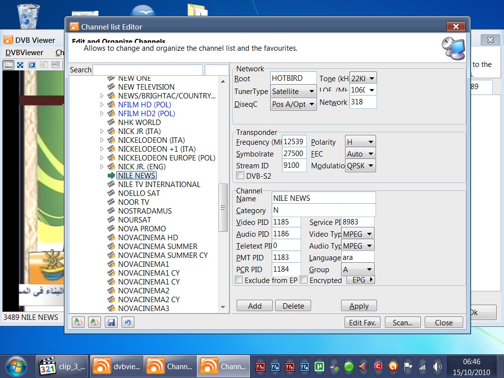

leecovuk Posted October 15, 2010 Posted October 15, 2010 Hello, I've had a situation, on 3 separate runs of Transedit, where the same 4 channels have been classified 'dead' whilst they are in fact active. Transedit preview displays the picture or sound as normal active broadcasts as does DVBViewer itself. I run Transedit only when DVBViewer is not open. I am using Transedit 3.6.0.0 and DVBViewer 4.5.0.0 In case it helps pinpoint what I or Transedit are doing wrong, I am attaching to this post : 1) Transedit.ini 2) A screenshot of one of the 4 channels in DVBViewer's Channel Editor. Before taking this screen grab, I had updated the channel list in Transedit after the scan, and closed Transedit. Then opened DVBViewer. If I can help any further, feel free to ask me for anything specific. Thanks, Lee UK TransEdit.ini Quote
Derrick Posted October 15, 2010 Posted October 15, 2010 You'd better uncheck in transedit "scan NIT" and "always scan with auto FEC detection". The NIT is not very reliable and with auto fec you might miss dvb-s2 transponders.. Quote
Griga Posted October 15, 2010 Posted October 15, 2010 I've had a situation, on 3 separate runs of Transedit, where the same 4 channels have been classified 'dead' whilst they are in fact active. From the TransEdit manual: Please regard the displayed dead channels as suggestion, not as fact. Maybe they are only temporarily missing, because they are not receivable due to bad weather conditions or other reasons. Particularly when scanning transponders that deliver no results, TransEdit may wrongly assume that channels from another satellite position are dead, if the orbital position is missing in the channel list data. In case of doubt use the Preview function to assure that a channel is really „off air“. Quote

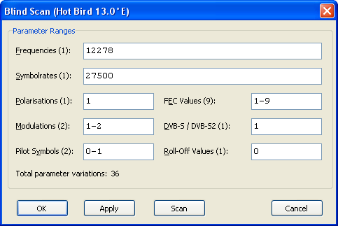

Griga Posted October 17, 2010 Posted October 17, 2010 Also, I believe Griga said recently that Hauppauge cards need the Pilot Symbol and Rolloff values for DVB-S2 channels. Pilot Symbols yes, but Roll-Off doesn't seem to have a significant effect. You can leave it set to 0.35 throughout. However, if I have to enter transponder details manually, where can I find those parameters? By trial and error However, you can let the TransEdit Blind Scanner do the job. E.g. if you know that it is a DVB-S2 transponder, and you know the frequency, polarisation and symbolrate, but not the modulation, FEC and pilot symbols, simply let TransEdit try all remaining combinations. In case of success TransEdit will add a new entry in the transponder list with the correct parameters. The screenshot below shows how it works: Polarisation = 1 -> try only vertical (0 would be horizontal, 0-1 both) Modulations 1-2 -> try QPSK and 8PSK Pilot Symbols 0-1 -> try Off and On FEC Values 1-9 -> try all FEC values in the dropdown list except the first one (auto = 0) DVB-S/DVB-S2 1 -> try only DVB-S2 (0 would be DVB-S, 0-1 both) Roll Off Values 0 -> try only 0.35 Or even better, please supply a constantly up-to date supply of suitably formatted transponder lists. Obviously, from one day or week to the next, they change. That's true. Keeping transponder lists and channel lists up-to-date is a time-consuming job nowadays. And you lazy sod want someone to do it for you? How much will you pay per month? I'm sure scanning shouldn't be this difficult! It would be much easier e.g. if you had a TechniSat SkyStar S2. It is able to detect modulation, FEC, pilot symbols and even DVB-S/S2 automatically. It doesn't care if you set a DVB-S2 transponder to DVB-S. However, it doesn't tell you what it has detected. It just works, but you never come to know the correct parameters. Scanning with the Hauppauge Nova S2 is more cumbersome, but much better for providing or publishing correct transponder lists, because you will know if the parameters are not correct... it simply doesn't work. Quote
leecovuk Posted October 17, 2010 Author Posted October 17, 2010 Thanks Griga, So should I just always use Blind Scan with DVBViewer or Transedit with the Hauppauge card I/we have? ie no need to worry about finding or manually compiling up to date transponder lists? However will I get overwhelmed with almost duplicate transponders? For me it's not a case of being lazy asking for up to date transponder lists. It's a case of they seem to be difficult to find or achieve, possibly as you say due to the requirements of my card. Thanks for the parameter help you posted. However could you please give an example? For instance, if we take this line from Kingofsat's downloadable Astra 28.2 East list : 81=12460,H,29500,34,S2,QPSK What does the '34' mean? And how would 'S2,QPSK' translate into what is needed for my card with DVBViewer or Transedit? Or, if we look at the same line offered by fastsatfinder for ProgDVB, it takes this form : 79=12460,H,29515,34,NBC_QPSK,p:off,r:x Is one or the other more suitable for my usage? Or either would need adjusting? Thanks, Lee Quote
Griga Posted October 17, 2010 Posted October 17, 2010 What does the '34' mean? FEC 3/4 And how would 'S2,QPSK' translate into what is needed for my card with DVBViewer or Transedit? Maybe DVB-S2 and QPSK? You are asking for things that are very obvious resp. that have already been explained. Try to be a bit more proactive. Quote
