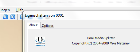

mague Posted December 20, 2011 Posted December 20, 2011 Ich klinke mich hier nochmal ein. Versuche seit geraumer Zeit das online Plugin ans laufen z bekommen, Erfolg = 0 Ich bekomme es trotz korrekter Installation garnicht angezeigt. Dachte erst es sei ein Sicherheitsproblem unter Win 7(Fluch & Segen), also habe ich den DVBViewer nochmal komplett auf einer anderen Partition installiert...nix. Kennt das Problem noch jemand ? Me Plugin works, OSD XML works, but i cant watch any video on youtube for example. Haali is installed, but DVBViewer doesnt load it. At least Haali is not in the tray where it usually is. Status of DVBViewer is: unknown Quote
nuts Posted December 20, 2011 Posted December 20, 2011 Did you try to set haali as splitter in your youtube.fpg? It also should be possible to create several "youtube.fpg" files (i.e. youtube_mp4.fpg & youtube_flv.fpg) with different splitters to get more control of the directshow filters. Quote
mague Posted December 22, 2011 Posted December 22, 2011 Yes, [General] DisplayName=Youtube Stream Description=LAV Splitter/ffdshow DXVA Conditions=.you,Stream Enabled=1 [splitter] CLSID={171252A0-8820-4AFE-9DF8-5C92B2D66B04} Name=Haali Media Splitter [MPEG2Decoder] CLSID={0B0EFF97-C750-462C-9488-B10E7D87F1A6} Name=ffdshow DXVA Video Decoder [H264Decoder] CLSID={0B0EFF97-C750-462C-9488-B10E7D87F1A6} Name=ffdshow DXVA Video Decoder Does this help ? 22.12.11 17:56:29.439 TUCStreamThread Could not connect, Error: 10038 22.12.11 17:56:29.439 TUCStreamThread Could not connect, Error: 10038 Quote

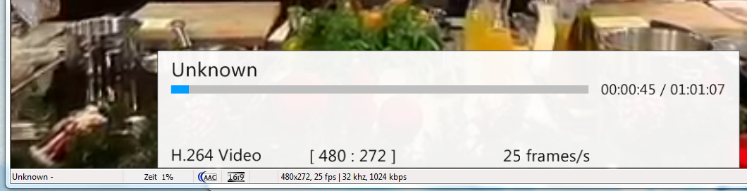

mague Posted December 26, 2011 Posted December 26, 2011 (edited) Allright Some stations work, others not Cant get youtube to work though. This is "Lanz kocht" from the ZDF Mediathek. Shouldnt it display the title ? Like "Lanz kocht! vom 16. Dezember 2011" Inside the folders (in this case ZDF - "Lanz kocht") of the casts there is only listview and small icons available. No big icons . I found something else. Haali is recognized as 001. Is this a windows 64bit issue ? Edited December 26, 2011 by mague Quote
nuts Posted December 26, 2011 Posted December 26, 2011 Some stations work, others not Cant get youtube to work though. Its all about setting up directshow properly. I will try to make some youtube.fpg's examples (not so easy ). Quote

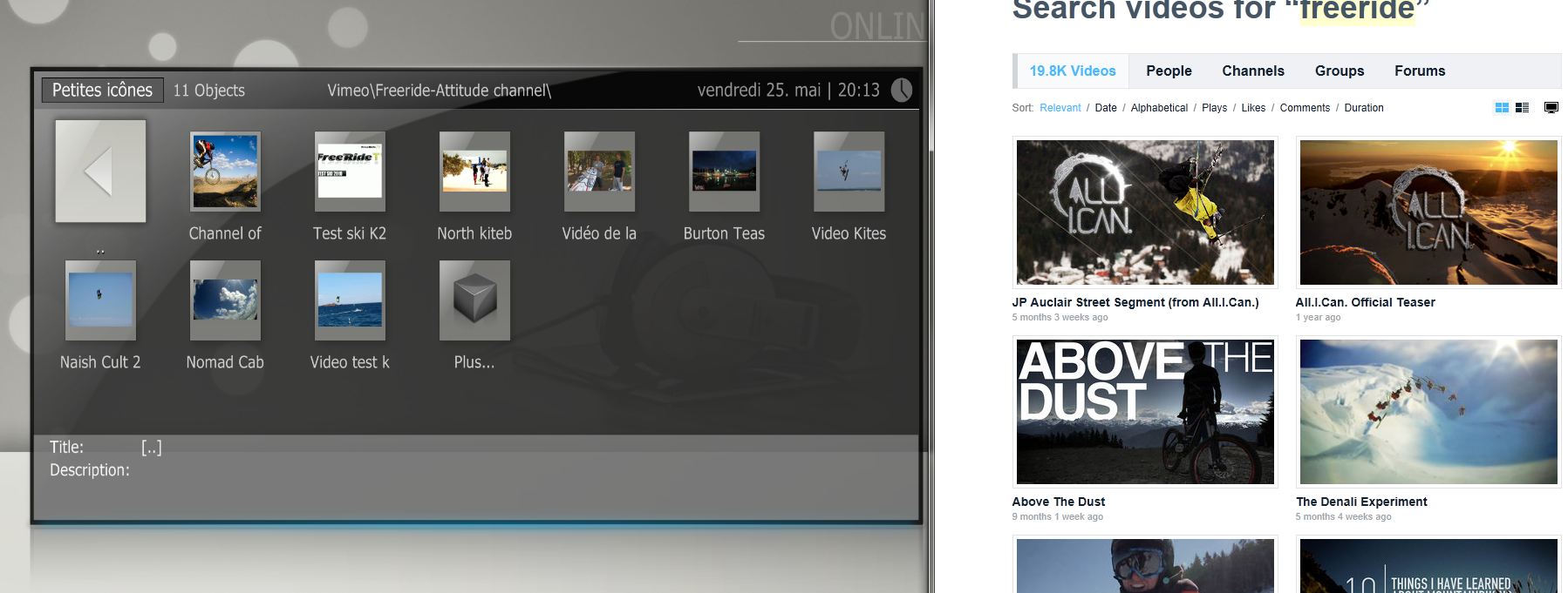

SnoopyDog Posted May 26, 2012 Posted May 26, 2012 Unfortunately, I have this here for all .mp4 videos, online and on my harddisc from time to time. Only on Windows 7 with different direct show filters. I don't have this with Windows XP and overlay renderer. I "solve" it by pressing the "0" so the video restarts playback. No solution so far Vimeo search: Right now we use the vimeo "simple" API, where you don't have to register your application. The simple API has no search functionality at all, so i do some kind of pseudo search. Quote
