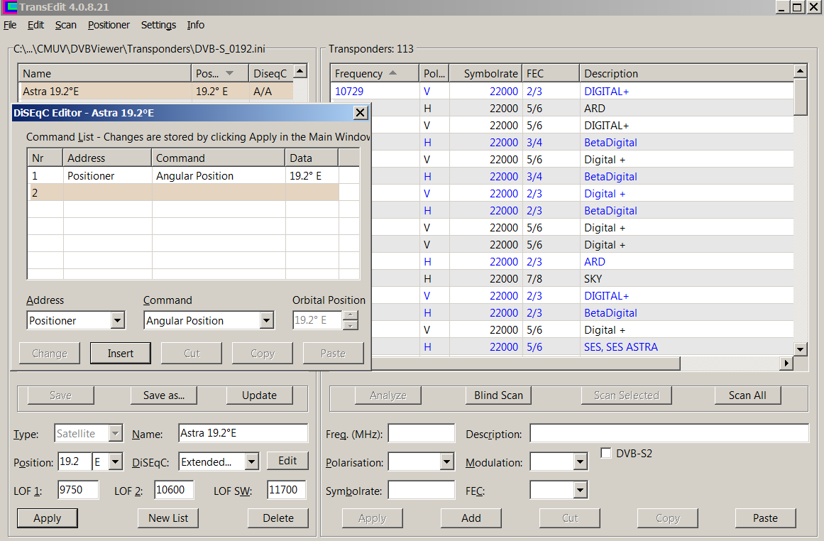

My Rotor is working in Transedit (Manual). I update the 192.ini file and try it in dvb vierwer. Still not working.. In the position console is it working manual. I try to repeat this in DVBViewer. Not working. I read article

Then I change DiSEqCCount.x=1 to 2 3 not working no success...

Did you use angular position or extended diseqc in transedit?
I try both. Now I am using Extende mode incl. delay to fix the problem.
Now it running with DVBViewer, so I think I solve the problem..
I repeat 3 time the command send to the rotor
