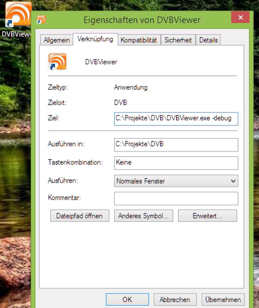

hackbart Posted November 29, 2017 Posted November 29, 2017 We do talk about the current DVBViewer version, right? You have to start the DVBViewer with parameter -debug. You should select a tuner which is not available by physical devices. For example if you are outside US&A you can use ATSC for your colossus. Then open the scanner, select ATSC and press scan frequency. I do need the debug.log created if you start the application in debug mode. This contains all steps done while assembling the graph for this device and it also includes the error message, if there is one. Quote
