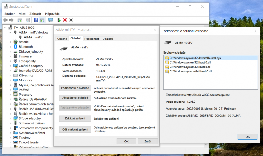

I have used DVBViewer software with my Pinnacle PCTV NanoStick for years, but now I decided to buy some new hardware that supports DVB-T2. This new USB stick is "Alma mini TV" and and it is very similar to "Freenet TV Stick" - maybe almost identical. But DVBViewer doesn't recognize it. Is there any chance to add support in future versions? This Alma mini TV stick uses libusb driver and SMiTPayTVPlayer.

Well officially supported is not that exact. The SMiT device comes with a WinUSB based driver and the first version was quite self explanatory, so it was possible to create a library which interacts with the driver in order to tune and to receive the data. However quite a few weeks after releasing the DVBViewer with support for these sticks, Freenet provided a firmware update. Which made working with the stick impossible. There are a couple of encrypted communications between driver and firmware vice versa. If you (or google translate) know a bit of german you might check this link: https://www.rundfunkforum.de/viewtopic.php?f=4&t=29210&sid=63bd8583f71b293cdfb2eefda1601ac6&start=105
The author of the dll is quite active there and he also started this thread in the Rundfunkforum.
Christian
PS: I probably should point out that the temporal distance between the DVBViewer release and the  firmware release by Freenet was just coincidence. I also stood in contact with SMiT, but they where unable to provide information about the driver itself, because of NDAs with the companies using the hardware. As you know whenever CI+ comes into play the fun stops in all kind of ways ?
OK, that is not good news, but thank you for the explanation. For now, I will have to be "satisfied" with the SMiT TV Player alias ALMA miniTV Player. But if someone will find out a way how to play TV with this stick in DVBViewer, then please let me know. B)
