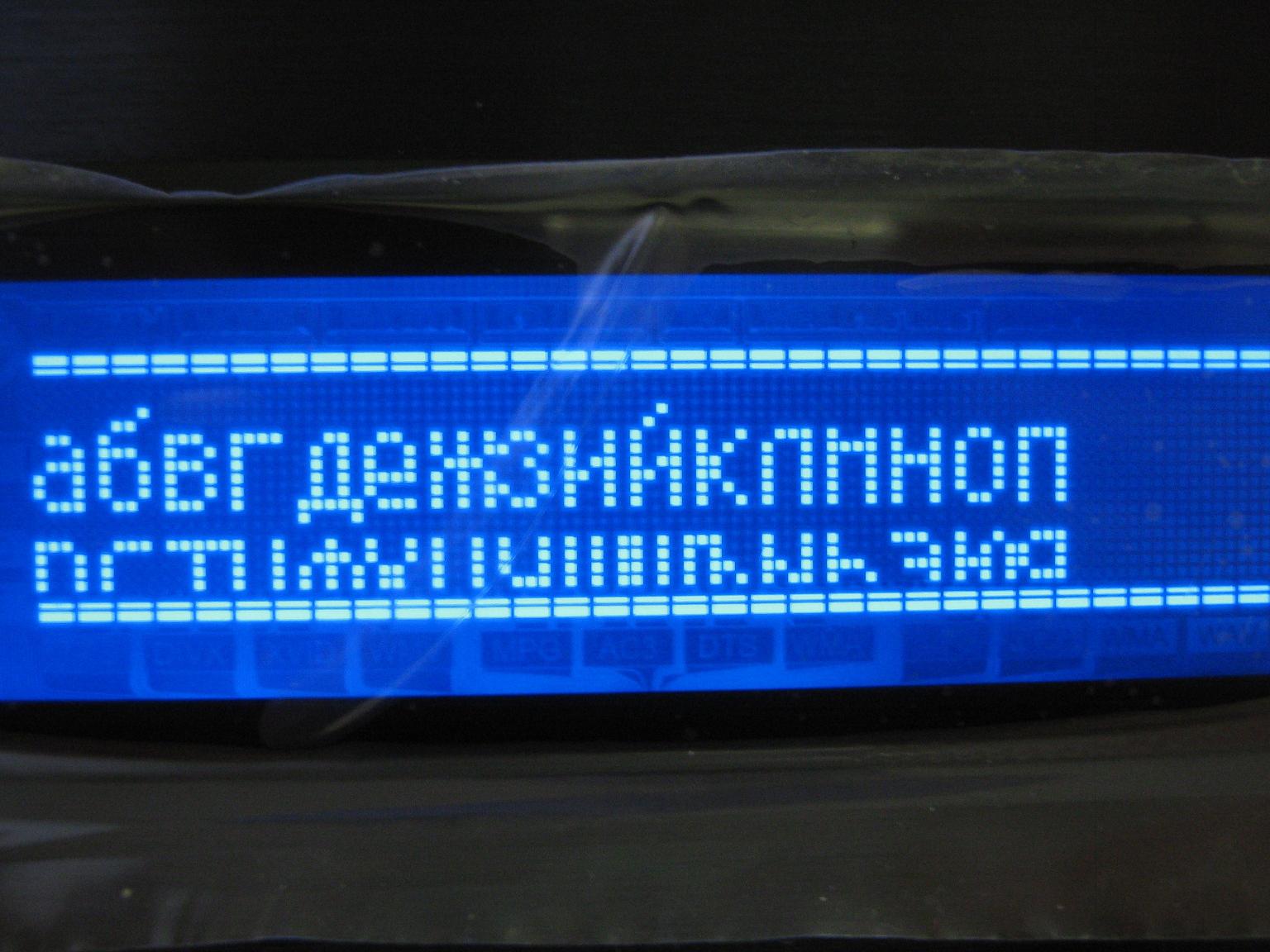

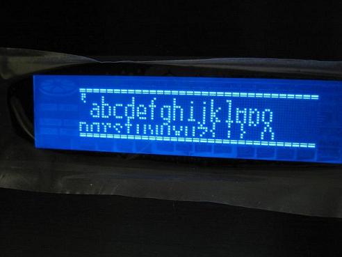

markymark Posted November 28, 2008 Author Posted November 28, 2008 No, latin characters not correct Okay, that meets my expectations. Apparently, you just dont have the proper font installed. I will check that at home. Best, MM Quote
Sosulev Posted November 29, 2008 Posted November 29, 2008 (edited) The standby problem seems to be common (but not at my machine) and related to the fact that the iMON Software re-initializes the display after startup. Some users have resolved this issue by automatically restarting the plugin after stand. see the german thread for details. Unfortunately I do not know German at all. I have made experiments with a standby problem. Frontview Software re-initializes the display after standby.After a standby tried to kill process IMONPlugin.exe and then to start again, with the help nncron sheduler. Thus in IMONPlugin customisations of language and screen monitor type are lost. Can describe solution of this problem? Okay, that meets my expectations. Apparently, you just dont have the proper font installed. I will check that at home. And with impatience I will wait. Thanks big Edited November 29, 2008 by Sosulev Quote

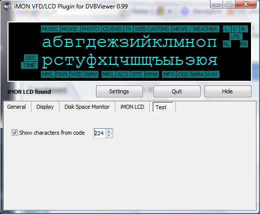

Sosulev Posted December 6, 2008 Posted December 6, 2008 Okay, that meets my expectations. Apparently, you just dont have the proper font installed. I will check that at home. Best, MM Hello markymark. I have not corrected a conclusion on LCD the message screen in two lines. There can be you will check up a font size in a plug-in. Quote
Paxero Posted December 15, 2008 Posted December 15, 2008 Unfortunatelly, I have the same issue with the fonts on OSD. Any fix available? Quote
Sosulev Posted December 16, 2008 Posted December 16, 2008 Unfortunatelly, I have the same issue with the fonts on OSD. Any fix available? I have understood that the table of fonts is formed in the program. Therefore, to solve a problem it is possible having changed a program code. Quote
markymark Posted December 21, 2008 Author Posted December 21, 2008 Unfortunatelly, I have the same issue with the fonts on OSD. Any fix available? (sorry for the late response) I just checked: The "Terminal" font is required by the plugin. Can you check that the font is available on your system ? If it is, please check available font sizes! Quote

Sosulev Posted December 23, 2008 Posted December 23, 2008 Please check if changing to a different font in the current 1.00 version helps Thanks big for correction. Now all works very well. It is necessary to solve a problem of start of a plug-in at inclusion from a hibernate mode. I will try to adjust restart of a plug-in by means of the program nnCron. http://www.nncron.ru/index.shtml Quote
