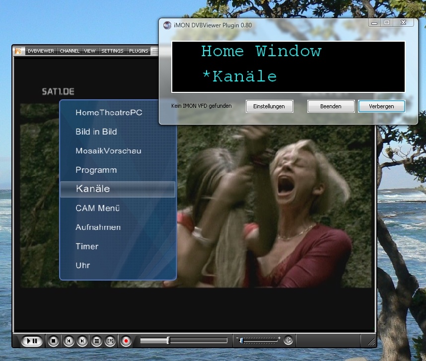

I just created a plugin to display status information from DVBViewer 3.2.9+ on an iMON VFD.  Feedback is appreciated!
Regards,
MM
PS: Thermaltake Media Lab is in fact the same VFD and works as well.
PPS: YOU MUST SET THE iMON SOFTWARE TO "PLUGIN" MODE IN ORDER TO MAKE THIS WORKING!!!!!!

Okay, here you got it:

Very nice, unfortunatly the german umlaute (äöü) are not displayed correctly... >_<
Hmmm ... on the VFD or in the window? For the window, I am aware of this issue. I just checked:
"Alarm für Cobra 11" and "4 Flügel ..." are fine on the VFD.
I got a Thermaltake MediaLab 2x16 VFD ... throught theyre all the same ...

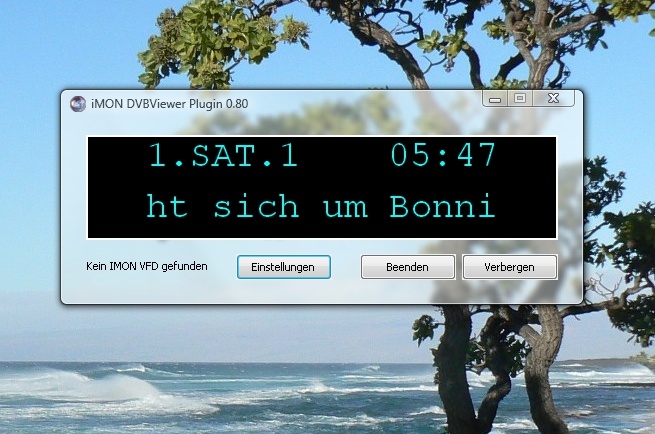

here comes a new Version after quite some time. Important changes are
- Ongoing recordings are now displayed
- Enhanced Time/Date display if DVBViewer is not running.
Still, this plugin requires that you set your IMON software to support third party plugins.
For running the plugin, just start it (e.g., in Autostrart!.
Feedback is welcome

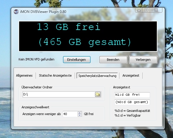

here comes an updated version with some new features :)
Changes in version 0.80:
- Disk space monitoring
- OSD navigation is reflected on the VFD (at least some)
- New user interface with Vista glass support
- Clock can be disabled for program display
- Configuration file is now stored in the appdata folder (required for vista)
- Indicates if VFD is actualled found
Feedback is welcome!
PS: A localizable version including english language support is on the way, but not tomorrow :bye:
imonplugin_080.zip
