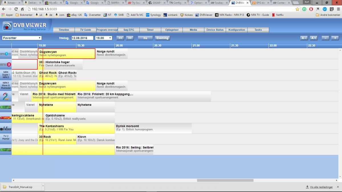

rolf@fuglseth.net Posted August 12, 2016 Author Posted August 12, 2016 I understand. What I try to explain is that I have epg data alle the time for all my channels. But in the epg Window I see only the program sent one hour behind and coming the next hour. Se file attached Quote
Griga Posted August 12, 2016 Posted August 12, 2016 Looks like you are only getting the present/following EPG data. Follow the link to the TransEdit manual above and you will understand what I mean. The question is how and where the "schedule" data is provided. BTW: There is a tweak that may help (mere guessing). Stop the Recording Service, launch RSTweaker.bat in the DVBViewer installation directory (launches Tweaker.exe for the Recording Service), find and untick the "Use faster EPG Updater method" checkbox, save, re-start the recording service, trigger an EPG update on the Tasks page of the Web Interface and see what happens. If it doesn't help tick this checkbox again because unticking it may slow down the EPG update considerably. Quote

Griga Posted September 11, 2016 Posted September 11, 2016 0.8W 12399 H 08-13 12-11-43.zip I have tried the procedure above. Sorry, I've overlooked it. Much quoting, little link To make it short: The transponder only provides present/following EPG, wich means, what is running now and next. Maybe other frequencies deliver more EPG data for the channels in question, but not this one. Quote

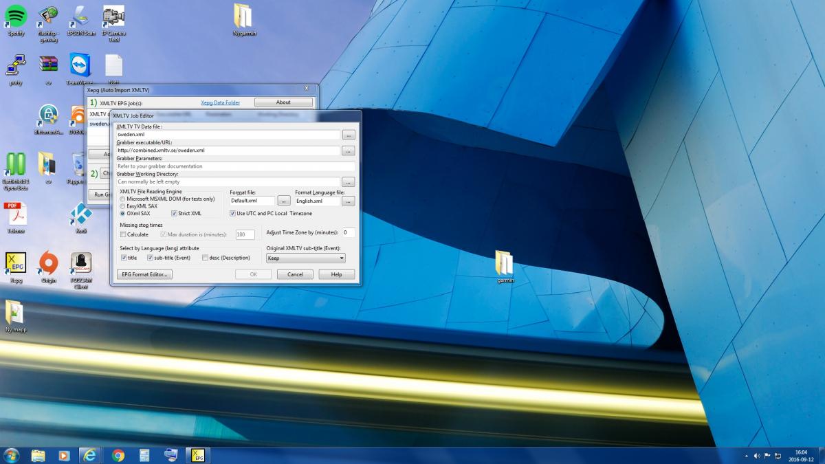

wikings1 Posted September 12, 2016 Posted September 12, 2016 You run the xepg app, then click on Help. Inside there you find a complete explanation Can someone make screenshot of the config for Nordic epg (Swedish) Quote
wikings1 Posted September 12, 2016 Posted September 12, 2016 i am getting this error. I want epg for viaasat and canaldigital Nordic (Swedish) Downloading: viasat.se From: http://xmltv.xmltv.se/16.viasat.seviasat.se: ERROR: 404: Internet file not found Quote
wikings1 Posted September 12, 2016 Posted September 12, 2016 (edited) ok here is my config is it oki Edited September 12, 2016 by wikings1 Quote
McenterFreak Posted September 12, 2016 Posted September 12, 2016 in XMLTV Data file, try change sweden.xml to xmlse.xml Quote
wikings1 Posted September 12, 2016 Posted September 12, 2016 Ok i did it. it downloads and says succés but it doesent show epg on viasat se. Canal digital is working but i think its from sattelite Quote
McenterFreak Posted September 12, 2016 Posted September 12, 2016 Ok i did it. it downloads and says succés but it doesent show epg on viasat se. Canal digital is working but i think its from sattelite The EPG is not from Canal Digital or Viasat. It is from a free service that collect EPG. You need to pair it with the actual channel that you receive from your provider. Example SVT1 could be SVT 1 Sweden. Then you need to pair them in xepg. Again try to read the Help file in XEPG Quote
