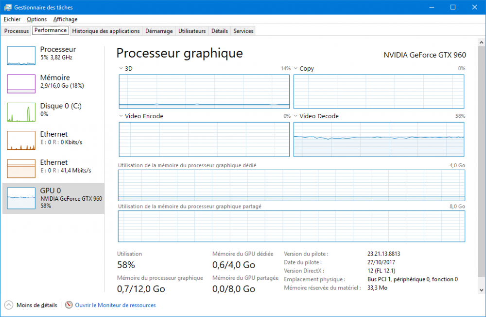

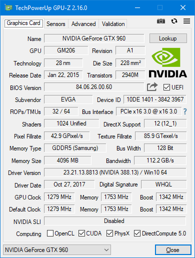

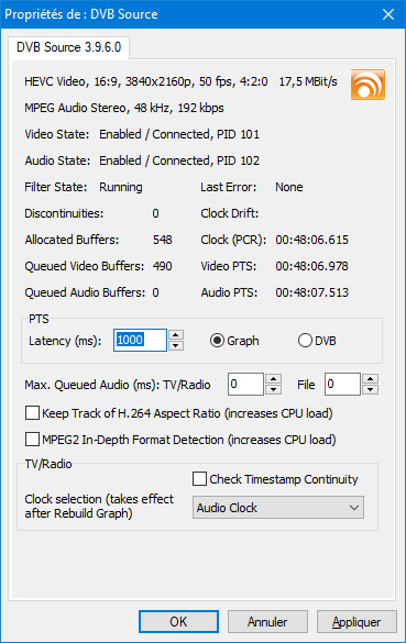

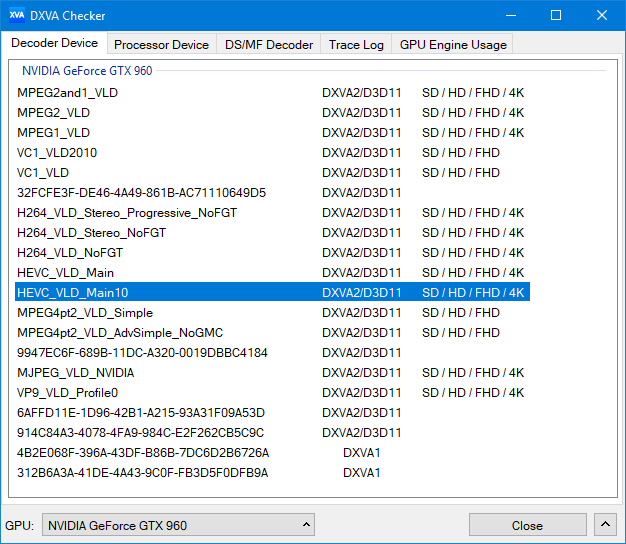

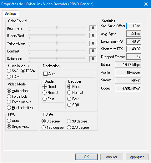

Here my tests:
First Live stream is From Hotbird , transponder 12539, channel sid 1101 Hotbird 4k.
This one is interressant, it has the highest datarate of the moment (30 Mbits) for UHD Hevc
On i7 + GTX 960 Machine, I have DVBViewer  6.1.4 + Latest Powerdvd + Latest LAV + Latest lentoid.
all dxva etc are setted correctly.
For this Channel, i got CPU 6 % and GPU between 40 and 50 %.
But i get little stuttering , i don't know if it comes from the fact i have UDP Inpput stream (no dvb card in this machine) , perhaps some cache to put in file(s) ???
Griga an idea ?
Same result for 2 other codecs.
So I have decided to move on Astra for transponder 10994, channel sid 2 UHD1 .
I put the result in pictures :
source.png.c1e22e22412d4203121c720a257b8bcc.pngCyberlink.png.836f9463a4cbe405b6ff7472d5554796.png
Gpuz.png.bfe8c086921c8968f93189a3118fc837.pngDxvaChecker.png.6f52b73a967fb6eff07a373e2863960e.png
Results for LAV filter are exactly the same on this machine as Cyberlink.
For Lentoid video codec, same GPU ressource , but CPU rise to 45 %, this is normal for software codec.
Result for this stream is 100 % fluent for all 3 codecs
Etienne
