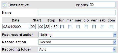

feucar Posted April 2, 2009 Posted April 2, 2009 (edited) Hi all, I'd like to ask some questions about webservice. I'm using recording service 1.4.7.90 (beta) and i'm trying to access the web interface using a pocketpc windows mobile 6.1 and its pocket internet explorer. This browser seems doesn't support the javascript functions extensively used by service's pages: java script:record('timer_new.html?aktion=timer_new&silent=1&time=39905,9253472222&channel=0','yes'); or java script:popup('epg_details.html?aktion=epg_details&time=39905,9253472222&channel=0'); This way seems to be impossible to record from epg or look to program details. Other issue: using standard web interface (not mobile) with internet explorer 6 on windows xp function "new recording timer" (without epg, new button from timers page) is not visible the channel selection combo box (see hardcopy). Thanks and compliments for the good work. Edited April 2, 2009 by feucar
Lars_MQ Posted April 2, 2009 Author Posted April 2, 2009 The second issue can be cured by using the corrected html template from here. The first issue: did you try the mobile (http://yourIP/mobile/) part? I know this needs also reworking but I'm having nor the time neither the resource (an actual device) to do it at the moment. So anyone who feels the need and has the knowlegde to work on this is welcome
feucar Posted April 2, 2009 Posted April 2, 2009 The second issue can be cured by using the corrected html template from here. The first issue: did you try the mobile (http://yourIP/mobile/) part? I know this needs also reworking but I'm having nor the time neither the resource (an actual device) to do it at the moment. So anyone who feels the need and has the knowlegde to work on this is welcome Thanks for reply. Second issue: I'll try. First issue: yes I'm, trying with the "http://yourIP/mobile" part. I've understood your message
janip Posted April 3, 2009 Posted April 3, 2009 (edited) Thanks for reply. Second issue: I'll try. First issue: yes I'm, trying with the "http://yourIP/mobile" part. I've understood your message http://yourIP/mobil is right. Small bug. If i timer superbike (13:00-13:45) and supersport (14:15-15:00) race with epg auto search and set both record 60min more time to end, then i will get one superbike timer. Edited April 3, 2009 by janip
