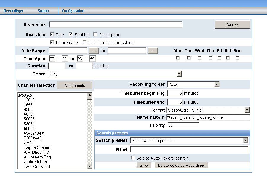

I would find it very useful if the auto search (record) could be set to only scan certain day of the week.
For example, lets say I want it to record our local news program (called "Anglia Tonight") on a Saturday/Sunday. Every week it seems to be on a different time late afternoon or early evening. So I'd like to be able to set it to search every Saturday/Sunday between 3pm and 7pm for "Anglia Tonight" on channel ITV1.
That's actually a very useful suggestion. :) Thank you, I'll look into it and try to come up with something nice. o:)
As for the replay suggestion: nice idea but it can not work. :blink: I don't know what replay or repeat means in french, chinese, russian, suomi etc. In german it could be "" (nothing because most station do not mark repeats), "Wiederholung", "Wdh" or several other strings... so no match there.
BUT you can always get aquainted with regEx and exclude your flavour of "repeat" there... ;)
That's actually a very useful suggestion. :blink: Thank you, I'll look into it and try to come up with something nice. o:)
Great stuff :)
Something like the attached mock-up?

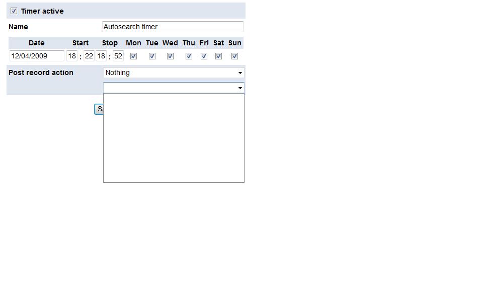

When setting the autosearch timer, I can see a dropdown box at the bottom, but it doesn't contain anything (see attached - I have one Task setup which appears ok on manually added timers)
Oh thats a bug. It shouldn't be there. Thanks for pointing this out, I'll fix it.
