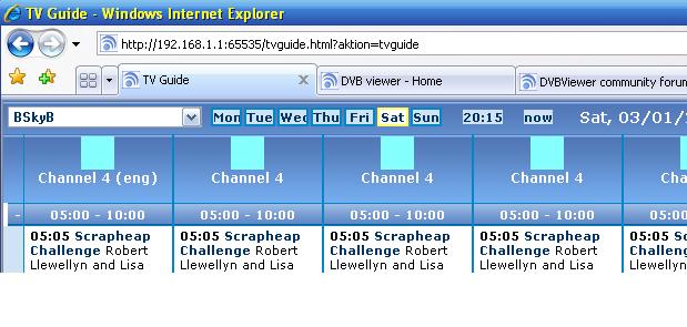

Lars_MQ Posted January 2, 2009 Author Posted January 2, 2009 Somehow you seem to have an old language file, the display is ok but there are entries missing in the lng file. And because english is the reference language there is of course no fallback to display. Please extract the attached lng file into the language folder in the dvbservice (V1.4.7)/DVBViewer program folder and stop/start the service. Looks like the recording service isn't seeing the same channel list. I'll investigate. Make sure the service is installed into the same folder as the currently in use DVBViewer and don't use usermode=1 (in the usermode.ini file in the DVBViewer programm folder). This will never work, because the Service has no knowledge of different user accounts. Best use usermode=2. My message was actually a cut from another post and I neglected to make it clear that I'm happy with the functioning of the recording service. I just think that it could be more than it currently is. Yes, I understood it. My reply was not meant in a negative way. I think also it could be a lot more and I working on it. But it is after all a one man project and I'm also heavily involved into the DVBViewer development, the forum and some other small sideprojects here. So I might not notice some problems or don't see a need to change somethings but as I said, I'm open for improvements. But you (not you personally) have to make my life a little bit easier and suggest a little more than "a little rough around the edges" OK, I'm rambling now, but I think I made my point rc_english.zip
AndrueC Posted January 3, 2009 Posted January 3, 2009 (edited) I copied the .lng file into the appropriate folder and it didn't make any difference, sadly. I've also noticed that the navigation buttons along the top are not always present as shown in the attached images. They are currently present when I view the UI on the server but not on my laptop. The difference is IE6 on the server and IE7 on the laptop. The Configuration page rendering issue affects both. Activating the recserv plugin did fix the service restarting issue though which is good. The channel list is still not matching DVBViewer even though they are in the same folder. The INI file contains: [Mode] UserMode=2 Root=CMUV\DVBViewer [Card] Unicast=1 Multicast=1 Filedevice=0 IPTV=0 Edited January 3, 2009 by AndrueC
Lars_MQ Posted January 3, 2009 Author Posted January 3, 2009 Just open the page via http://192.168.1.1:65535/ don't use direct links. As for the rest: it seems like a messed up installation. try deinstalling the recording service and on installing it new make sure it does use the correct DVBViewer program folder.
AndrueC Posted January 3, 2009 Posted January 3, 2009 (edited) Just open the page via http://192.168.1.1:65535/ don't use direct links. As for the rest: it seems like a messed up installation. try deinstalling the recording service and on installing it new make sure it does use the correct DVBViewer program folder. That's the URL I'm using. I just created a shortcut for the home page. Interestingly having just tried it again the button are there now along with the banner along the bottom. It makes it look a lot better, funnily enough. The config page still isn't right though. Most odd. Edit:Ah ha! Sorta I get the buttons and bottom line if I visit the controller after I've opened this forum. Weird, eh? Edited January 3, 2009 by AndrueC
Lars_MQ Posted January 3, 2009 Author Posted January 3, 2009 There is no connection at all between the forum and the web interface. It must be some setting of the IE or something like that. I have no clue what the problem might be...
