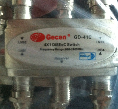

gqsun Posted May 23, 2013 Author Posted May 23, 2013 hi yes it looks like this, polarization is switched by frequency, however mine has 4 independent output. the diseqc looks like attached picture. currently I have 2 of this kind of lnb, each lnb connected with 2 outputs, each output is connected to an input on diseqc. in another word I have 2 diseqc, each with 2 inputs connected to a lnb of this kind. Quote

Griga Posted May 23, 2013 Posted May 23, 2013 yes it looks like this, polarization is switched by frequency, however mine has 4 independent output. Are there 4 outputs for supplying 4 receivers (Quad LNB)? Or do they have some other meaning? the diseqc looks like attached picture. I see. It is this one: http://www.gecensat.com/msg.php?id=58 in another word I have 2 diseqc, each with 2 inputs connected to a lnb of this kind. I am not sure how this setup is supposed to work, but I guess - You have two Quad bandstacking C-Band LNBs for receiving two satellite positions. Each of the 4 outputs of a LNB is able to deliver all frequencies of the satellite position, so you can connect 4 receivers to it. - You have two 4 in 1 DiSEqC switches for supplying two receivers. Each switch is connected to two outputs of LNB 1 and two outputs of LNB 2. That means, two inputs of a DiSEqC switch get satellite position 1 and two inputs get satellite position 2. - You have two transponder lists for the two satellite positions, both with the original C band frequency and polarization for each transponder. - It is expected that two of the four DiSEqC commands (PosA/OptA, PosB/OptA, PosA/OptB, PosB/OptB) enable receiving satellite position 1, and the other two satellite position 2. Is this correct? If yes, have you tried all of the four DiSEqC commands in TransEdit? Don't forget to click Apply after changing DiSEqC. What I am talking about is: in transedit I put 5750 in lo1 and 5750 in lo2, only this way, it can scan H/V channels correctly. but in DVBViewer I have to put 5150 in lo1 and 5750 in lo2, only this way, it can scan H/V channels correctly. according to the manual of lnb, 5150 is for H and 5750 is for V polarization. Lately I have added support for DishPro bandstacking LNBs in TransEdit (see here). The band stacking support is enabled by entering different values for LOF1 and LOF2, and setting LOFSW to 0 or 1. LOFSW = 0 switches the 22 khz signal off, and LOFSW = 1 switches it on. The values that you have entered enable the bandstacking support. However, with DishPro LNBs it is the other way round. LOF1 = 11250 MHz is for V polarization, and LOF2 = 14350 MHz is for H polarization. That's why the LOF values have to be swapped in your case. As far as I know the DVBViewer Pro scanner does not support bandstacking LNBs at all, so I wonder why it works. Nevertheless DVBViewer Pro should be able to handle scan results exported from TransEdit to the DVBViewer channellist correctly. TransEdit sets a bandstacking flag in the scan results, and its meaning is known to DVBViewer Pro. Quote
