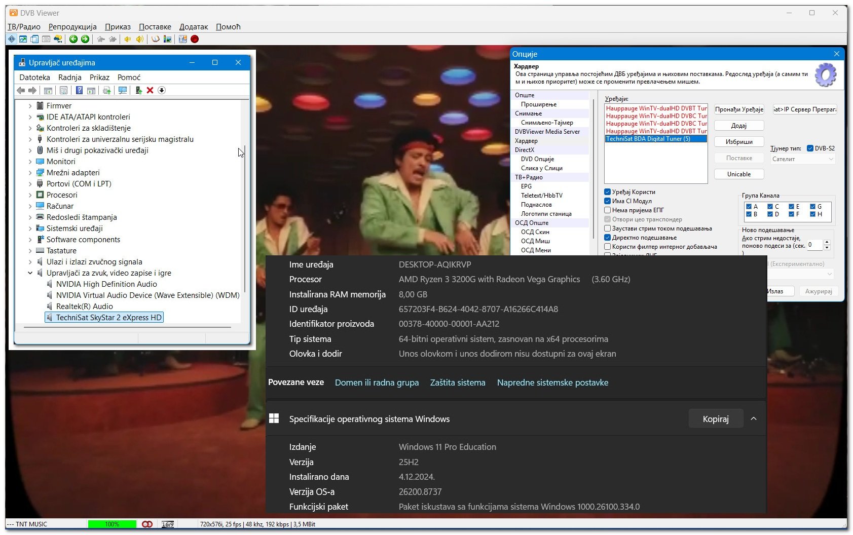

milan58 Posted June 25 Posted June 25 Has SkyStar 2 eXpress HD already been installed on Win11, or do you want to install it for the first time? SkyStar 2 eXpress HD needs to have additional power connected, I think it's 5 volts. Check out my post https://www.DVBViewer.tv/forum/topic/75184-win11-technisat-skystar-hd2/#comment-525247. The procedure is the same for SkyStar 2 eXpress HD. It still works for me on Windows 11 25H2. Quote

Reii Posted June 27 Author Posted June 27 update managed again to install it as network adapter in windows 11, and worked and ofc i needed the add hardware legacy option, i did multiple restart to the pc to make sure if im gonna get the yellow triangle again or no, and surprisingly its working but still i do have the problem with sound, video and controllers one, it just doesnt detect and when i do the add hardware legacy, it hit me with code 10 error and yellow triangle as usual even tho its working as network adapter Quote
