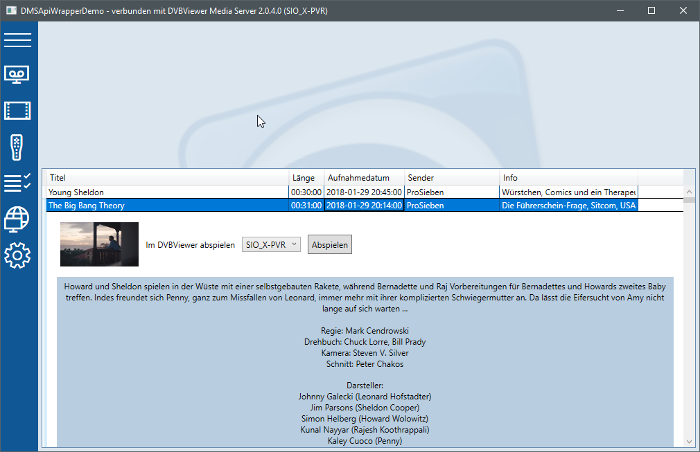

Siox Posted February 2, 2018 Author Posted February 2, 2018 Wer den Wrapper in einer zum Wrapper begleitenden grafischen Version einmal selbst Testen möchte, der kann dies in einer begleitenden App durchaus machen. Die Anwendung läuft ab WIndows 7 egal ob für x86 oder x64. Da ich den Sourcecode dafür noch nicht freigebe, hier nur der Download über meinen (leider nicht so gut gefüllten) Blog. Den Sourcecode zu dieser Anwendung werde ich aber auch über Github frei zur Verfügung stellen. https://code.sp-datenbank.de/11-coding/csharp/16-c-DVBViewer-media-server-api-wrapper.html Quote

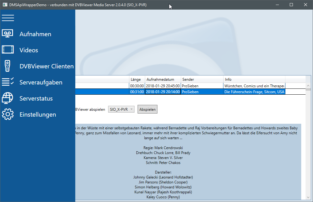

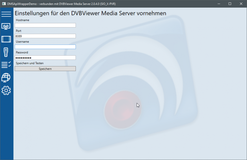

Siox Posted February 5, 2018 Author Posted February 5, 2018 (edited) Habe die komplette UI nochmal die letzten Tage komplett überarbeitet. Das heißt Fehler etc. Den Sourcecode habe ich auf Github online gestellt. The completely UI Demo has been reworked to fix error messages and crashes. I added multi language support for future options. Now german and english are supported. The source code was uploaded to Github, check the thread's first post. The ApiWrapper version was changed to a realistic value. Edited February 5, 2018 by Siox Quote
majstang Posted February 5, 2018 Posted February 5, 2018 2 hours ago, Siox said: english are supported Thanks i did wait on that. Now its time to try it out and see if your wrapper might inspire me with ideas for my own similar projekt. Quote
Siox Posted February 6, 2018 Author Posted February 6, 2018 Don't forget, the wrapper is language independent. It is a library. Only the UI Demo has support. Quote
