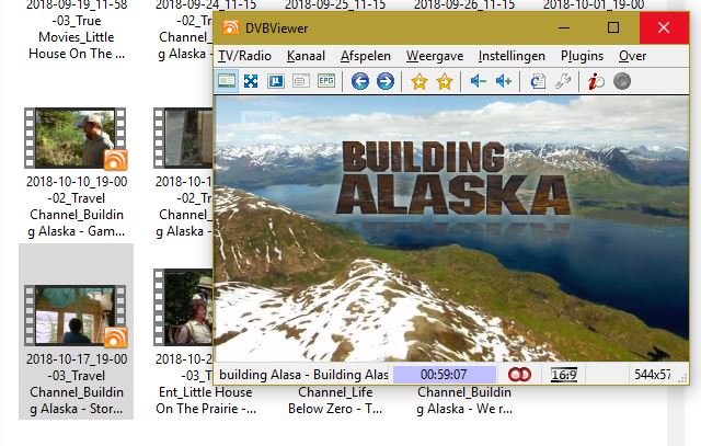

  1. Hi, I did not use DVBViewer for a while... but i am back, my setup works I have a Terratec Cinergy S2 PCI HD receiver, working on windows 10 (most new updates) I do not use edge, but firefox. (versions 64 &64bit) I used to open a (recorded) stream from the mediaserver localhost browser pressing the play button on the description, either in the whole recordings overview or the separate recording. That would open up a open with popup, that I found i can now only get when in the stream config , by pressing start direct stream. If I open the file(s) directly from my harddisk they play in DVBViewer. But if i try to open the master.m3u8 file from the temp folder which i believe is created when pressing the play button, i get nothing playing in DVBViewer, and when i open the url i find in it in localhost like this: http://localhost:8089/stream.m3u8?preset=2&streamid={0B0D3BA1-8C92-4B7D-939A-8490B33852AD} i get a 404 not found, maybe that is not how to test it, but i tried. I do see that in the edge browser, when pressing the play button, it plays the file in the edge browser. Some examples attached as screenshots. There has been an itunes messing with the m3u and m3u8 files but i reset them to open with DVBViewer, i believe i found windows 10 cannot have none program associated with these files anymore, which i hoped to be able to get the "open ....m3u(8) " . But i am not sure if that would solve it either. If you have an idea how to get the play button working again from firefox, so that I can open it directly to DVBViewer and play it there again, as i was used to, I would appreciate it very much, Bernhard support.zip master-1.m3u8
