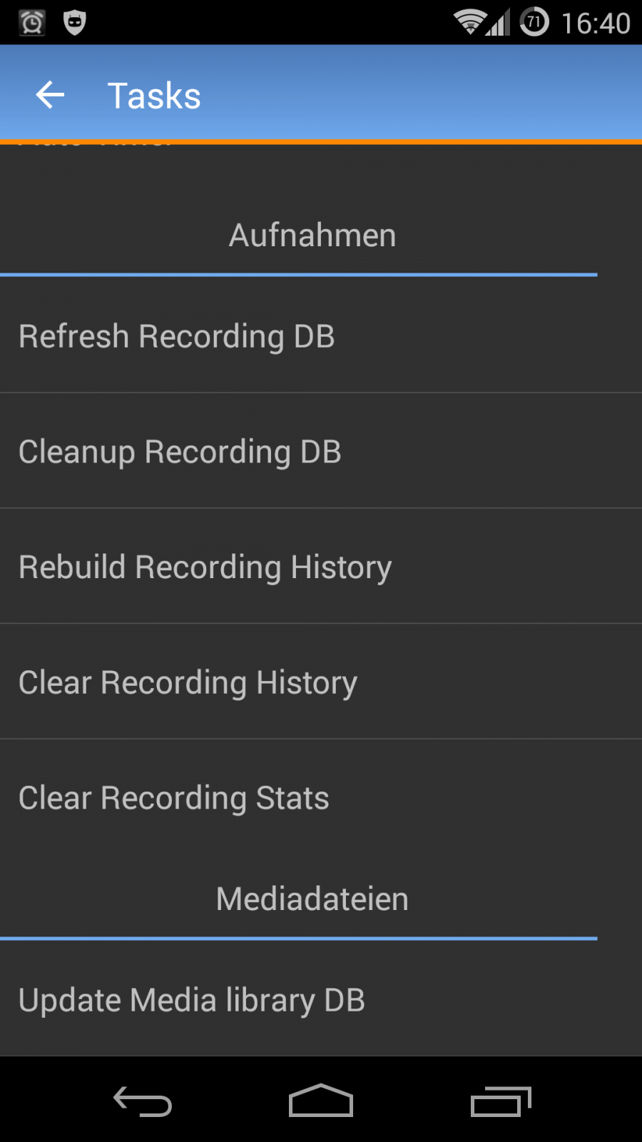

geclipse Posted March 5, 2015 Posted March 5, 2015 Two small points. 1) (English) In the Tasks screen there are 2 non-English words. I Had a look at the oneskyapp.com translations but there was nothing obvious. I think they should be "Recording" & "Media" 2) I have logos in Recording Service for UK DTTV channels. The logos are OK in the channel list (apart from a slight white bar above and below), but don't scale properly in the channel detail. My logos are 60x38 and look OK in Recording Service, though it may be my logos. Quote
